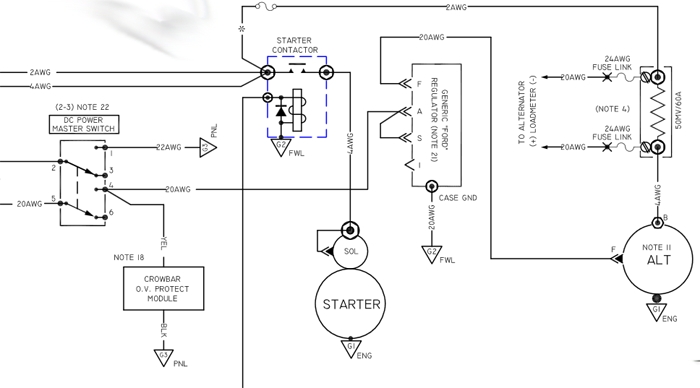

More specific to your original question, if you've
provided for alternative ov protection, then
any automotive alternator regulator will
probably do the job . . . some are quite reasonable.
http://tinyurl.com/y8tsebjz
Here's how it's wired . . .
[img]cid:.0[/img]

PostPosted: Tue Aug 08, 2017 3:04 pm    Post subject: Re: Questions for the alternator mavens Reply with quote
Hi Bob
Thanks for the advice and the info. I haven't made any firm decision on which way I will go so your comments will be most helpful.
Les

whereupon the votlage is held at 14.7
until recharge current falls to 100mA
-OR- 4 hours have elapsed.
Nobody charges with that kind of precision
in a vehicle. Any automotive regulator that
comes on line at 14.3 plus/minus 0.2 volts
is going to be entirely satisfactory for
your airplane. WAAaaayyy back when, the
regulators we put on Cessnas were stock Ford
products with a 14.2 plus/minus 0.2 volt
setpoing.

You can always accomplish that if you put a voltage divider in front of
the sense terminal of the regulator... say it's an 95%/5% divider... if
the regulator's setpoint is 14 volts, you'll fool it into providing 14.7
volts. If you really want to get fancy, use a linear potentiometer in
series with a fixed resistor to fine tune the voltage. Provide some
means for locking the pot's shaft in place!
