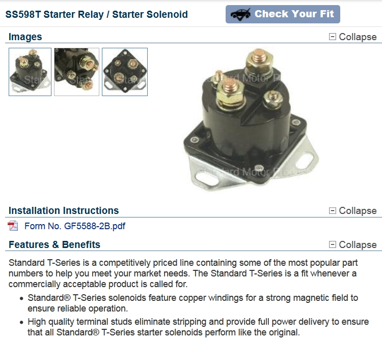

Thanks Bob, I was able to test the Napa version today, and so far it is working.

  Go to any local parts store and ask for a Standard
  SS598 or it's cross-referenced equivalent.
[img]cid:.0[/img]
