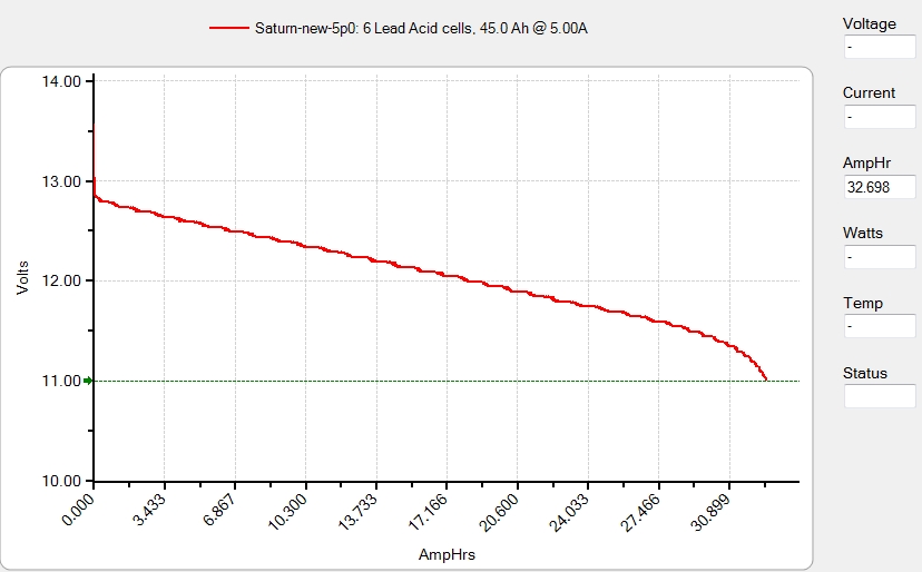

Here's one such device
http://tinyurl.com/mas7ea9
I've had these in the shop for over a decade.
Very handy. This tool produces data plots like
this:
[img]cid:.0[/img]
This was a new battery in installed in Dr. Dee's Saturn
just over two years ago. With a 5a load, it produced
just over 32 a.h. of energy output. I just replace that
battery yesterday . . . it had suffered a couple of run-down-
and-sit events . . . the worst thing you can do to a
battery. The new one is sitting in the garage with
a Battery Tender on it like my lab batteries.
