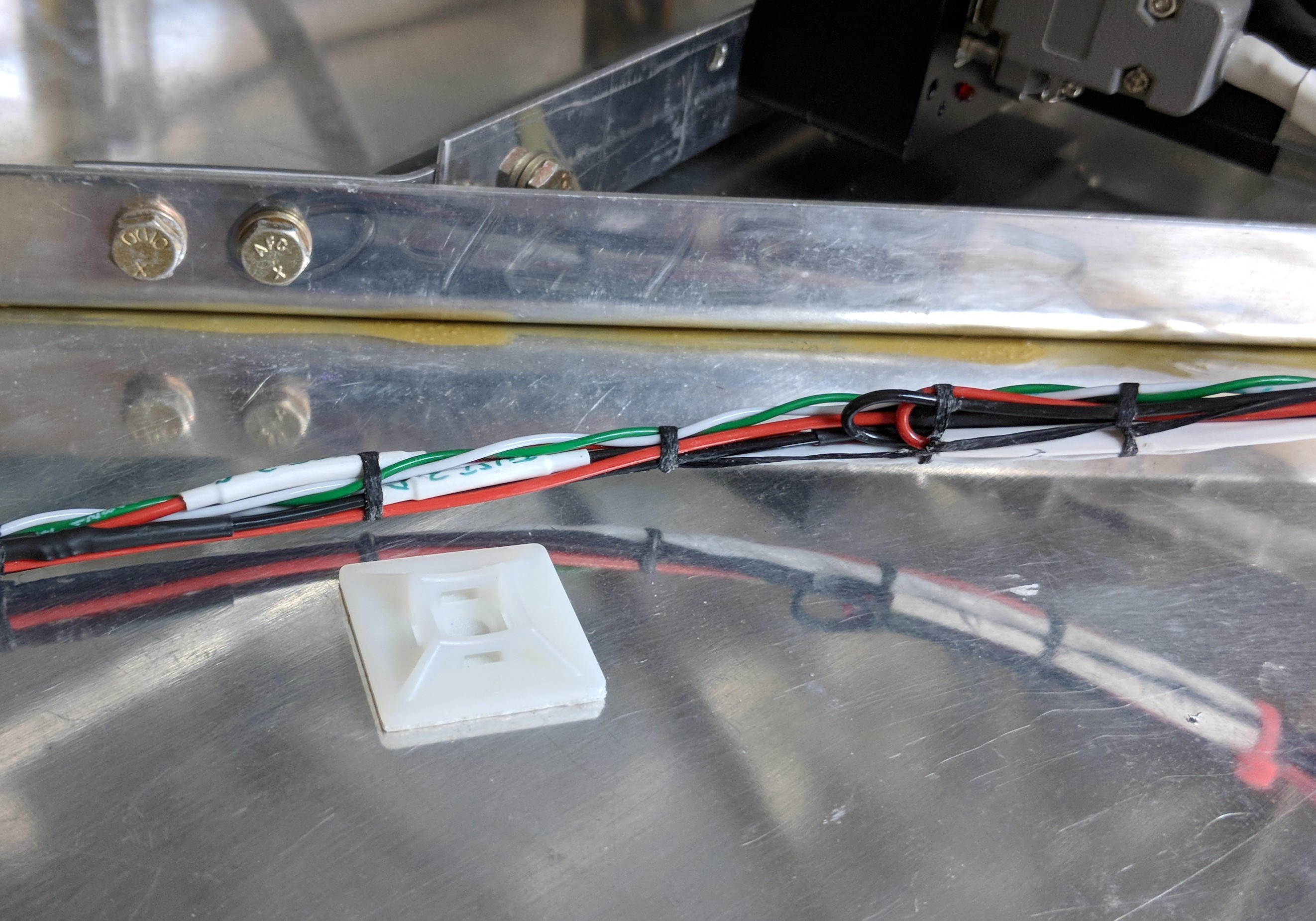

Folks,
Is there any reason why I should not use one of these anchors with the double stick foam in a position such as this?
    -- Art Z.

Hi Art;
I have tried these (or something like them). The ones I tried had the adhesive already applied. Some of them came unstuck after a while. If there is a way to put a small rivet through the center, I would do it.
Cheers! Stu.

The main reason not to use them is, like Stu said, they come unstuck after time. If you must use them, clean the aluminum with acetone first.

Aaahh, sticky-back zip-tie anchors, love 'em & hate 'em. I use them at work often. Sometimes they hold with a permanent bond and are very difficult to remove and often they do not hold at all. Over all, they do work well if you have a clean surface and apply in warm environment. But don't count on it.

Or remove the adhesive and use JB Weld.

If you use just the sticky back foam mounting, any constant load, even small, will eventually pull free.  As suggested by a previous post, I just scrape off the foam backing, roughen the surface with coarse sandpaper and mount the pads with JB Weld.  It takes a few minutes but you’ll only do it once.

I removed the sticky stuff on some of mine that were coming loose and replaced them with "Scotch Extremely Strong" mounting tape.  So far so good!

I've been using a dab of "shoe glue" right on the anchors without removing their adhesive.  Seems to work.  Shoe glue is tough stuff but can be removed if needed unlike JB Weld.

I suppose that I could use a squirt of RTV, too. In the spots that I am considering, there are only a few wires and there will be no significant force pulling on the mount.
Thanks for the feedback, folks.

methodology you would look for products like this:
6/6 black nylon, very high bond adhesive pads.
I've not been able to find anyone offering less
than bags of 100. Here's one offering from
Allied Electronics.
http://tinyurl.com/y7qjqy2m
Digikey has them too but higher priced
and lots of 100 minimum
http://tinyurl.com/y7rel4q4
Perhaps a few builders could team up and
buy a bag to split.
