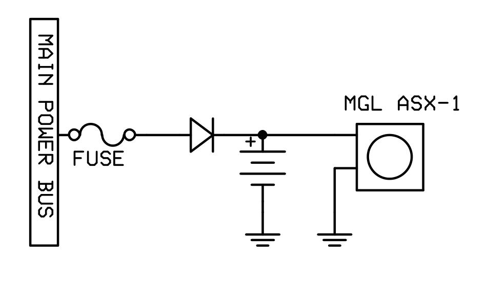

I need to install a small battery on my MGS Extreme so that it can be kept up and running during engine start for my VFR 601XL. I would like to keep the wiring as simple as possible, but also allow the 1.2 AH battery to be maintained by the alternator. MGL has an example that uses a diode and switch to power the backup pin on another system, but the Extreme does not include this.
How has everyone else handled this?

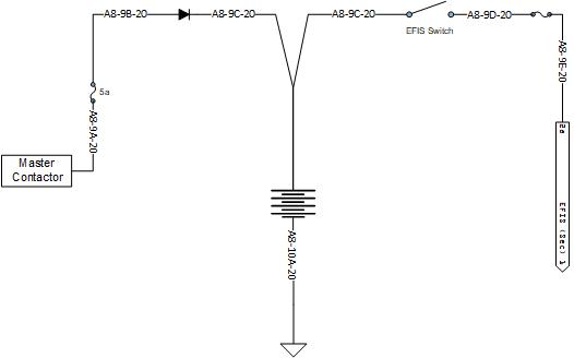

PostPosted: Sun Nov 12, 2017 1:26 pm    Post subject: Re: Simple EFIS backup battery wiring Reply with quote
I have a GRT EFIS and here's how I did mine. (The diode is a 10A/60V MBR1060G)
FYI, I have mine setup so I can power up the Primary EFIS prior to engine start so I don't have to wait for it to boot when I'm ready to start the engine.

Here is a circuit similar to the above. A battery fuse and switch could be added if desired.
 Filesize:  34.76 KB
 Viewed:  12008 Time(s)

Joe Gores
ceengland7(at)gmail.com
PostPosted: Sun Nov 12, 2017 4:04 pm    Post subject: Simple EFIS backup battery wiring Reply with quote
And if you want max voltage available in a simple circuit like that,
Schottky diodes are pretty cheap now. Just search ebay for lots of
options. Somewhat lower forward voltage drop than silicon.
