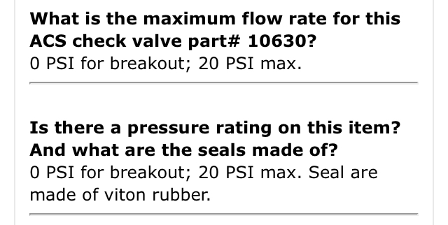

I’ve been looking for a check valve where can you get one with low psi?

PostPosted: Thu Nov 23, 2017 5:27 am    Post subject: Ice prevention on fuel vent Reply with quote
Here you go Dave..
http://m.aircraftspruce.com/catalog/appages/acscheckvalve.php?clickkey=6903

That was too easy Phil, looks just right.

It's installed by putting a "T" fitting where there vent exits the tank.   One leg goes down as usual and pokes out the bottom fairing.  The other leg goes to the check valve and never exits the wing root.
The orientation of the valve has to be such that air can pass through the valve in the direction of the tank (obviously).
The idea is that when the primary vent unknowingly becomes blocked (ice, bugs, etc), the check valve will open and allow venting from the wing root.   As the fuel pump sucks the fuel out of the tank, the pressure drops inside the tank, and that is what opens the vent without any intervention on your part.

trigo(at)mail.telepac.pt
PostPosted: Fri Nov 24, 2017 1:56 am    Post subject: Ice prevention on fuel vent Reply with quote
Tim
In the Q+A for this ACS valve, at the Aircraft Spruce website, it says that this valve breakout pressure is 0 psi.
Will this work for this application?

PostPosted: Fri Nov 24, 2017 5:01 am    Post subject: Ice prevention on fuel vent Reply with quote
If it says 0 psi I would say that is excellent and should be great.

PostPosted: Fri Nov 24, 2017 6:13 am    Post subject: Ice prevention on fuel vent Reply with quote
Yes. 0 psi on the valve to break it out.
I have a pair sitting in a box that I haven’t installed yet and can play with them to see how they behave. But 0 psi is what they claim for breakout and 20 psi max pressure.
It also mentions that the valve can be installed in any orientation.
[img]cid:A7C7F840-FF62-408C-A15B-0B245CE6B01B[/img]

PostPosted: Fri Nov 24, 2017 6:38 am    Post subject: Ice prevention on fuel vent Reply with quote
Keep in mind that a 1 PSI pressure (or vacuum) over a 12” X 12” surface area produces 144 pounds of force. Would you stand on your tank? Be careful which check valve you use.

On Nov 24, 2017, at 3:53 AM, Carlos Trigo <trigo(at)mail.telepac.pt (trigo(at)mail.telepac.pt)> wrote:
Tim
Carlos

Regarding that check valve...I just got around to looking at the link on this
Aircraft Spruce one, Phil.
I know you want one with a very very very low operating pressure (vacuum, actually).
If you get even a couple of psi that it takes to open the valve, your tank will
have probably imploded by then. This valve appears to be for fuel flow
return lines. It doesn't seem to give a spec.
I got a valve from McMaster Carr that had a cracking pressure of .3 psi.
http://www.myrv10.com/N104CD/upgrades/20090525/index.html
I can't say that the valve you linked to is bad, but I would just caution to
make sure that it's probably no more than 1psi of cracking pressure.
Any valve that takes more than that to operate may risk tank
collapse.
Tim

PostPosted: Fri Nov 24, 2017 8:30 am    Post subject: Ice prevention on fuel vent Reply with quote
By the way, Tim and all the experts in this forum
If the conditions create ice in the tip of the tube (which is in the air stream), why does it nor create ice inside the wing cavity as well?
Is it because the ice is created not only by the air temperature, but also by the positive dynamic pressure in the vent tube tip?
Wondering minds want to know …

I should have read again before replying... darn.
That check valve will work fine, as would any free flow valve, but, the other down side is your fuel vents are 1/4” tubing and that particular valve uses 3/8” fittings, so you will need to buy additional adapters to fit it in, which may require a little more creativity in mounting. At $27.50 it isn’t super cheap either but looks like good quality. I don’t remember what I paid, but it would be worth checking out what other valves you can find because if you can find one that is 1/8” NPT it may be easier to adapt. That said, mine is brass and is probably heavier than this one is too.
Tim
