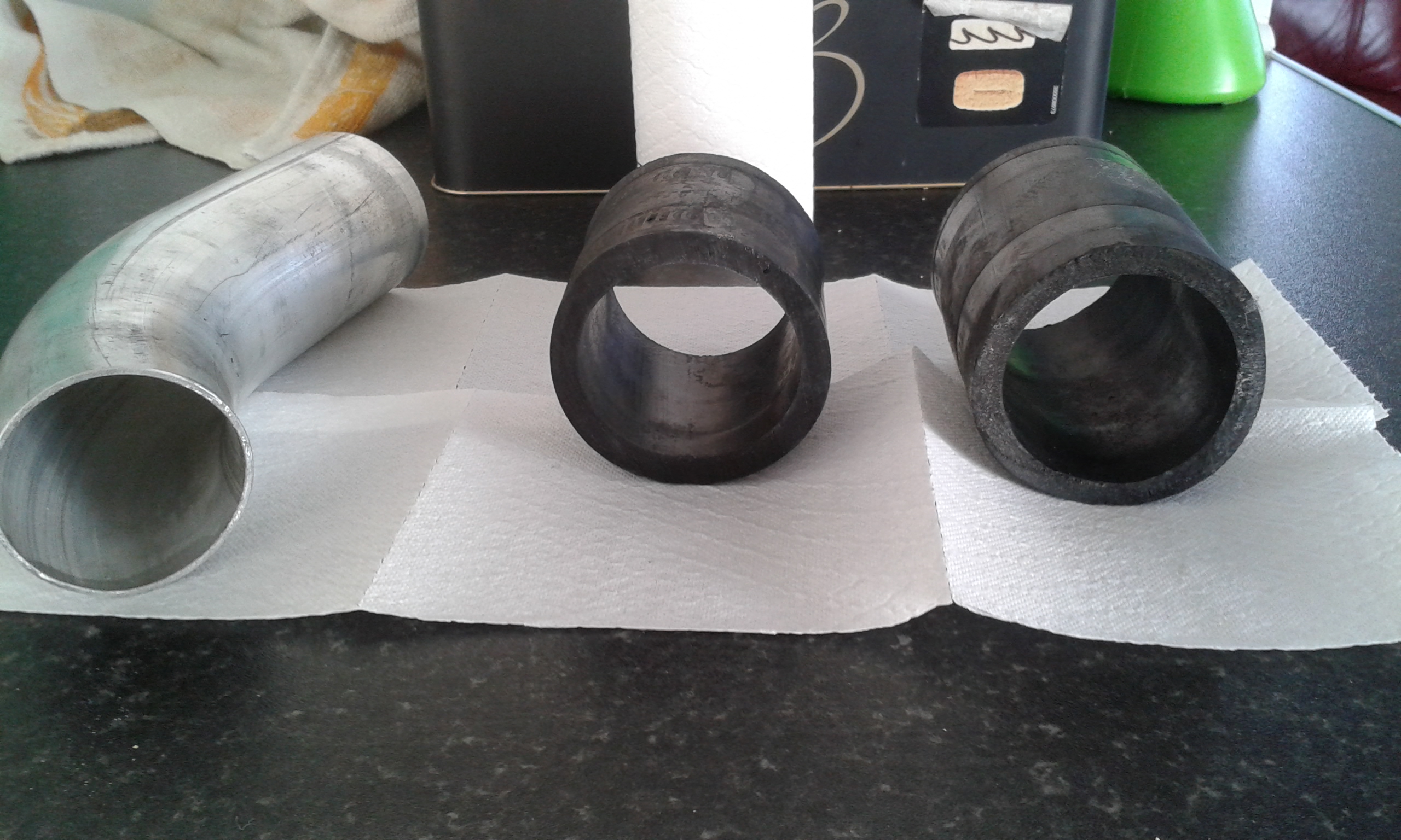

A picture of two section of original pipe from my aircraft, looked fine on the outside but definitely breaking up on the inside,
the amount of rubber actually exposed to the fuel was very small on my installation,
http://forums.matronics.com/viewtopic.php?p=476389#476389
http://forums.matronics.com//files/2f7baddf_784c_46cb_b920_6cacd3c0aa2c_984.jpeg
http://forums.matronics.com//files/8145fca1_5ba6_4e70_959d_0a589c4e6b43_883.jpeg

original pipe with 10 years use, did check it at five years obviously but it seemed fine at the time,
luckily Frank xuereb down the road from me had some spare original pipe going spare,

I have always tried to minimise Avgas use but some times that all you can
get, so Mainly UL91 with some Super unleaded as a last resort,
Yes i do try to leave the fuel tank full but not normally up the cobra,
The amount of Rubber exposed to any fuel is quite small, after the cobra i have a aluminium pipe so the two pieces you see just connect the pipe to the tank and cobra,
outside condition of the rubber is good,

as previously said i managed to get a piece of the original hose from
Frank Xuereb that will work fine until the next flying season when hopefully
a more permanent solution is found,
IMO if a hose designed for fuel cannot be immersed in fuel then it’s not fit
for purpose,
my last hose lasted at least 5 years before starting to degrade so an original hose should be fine until a proper replacement is found,

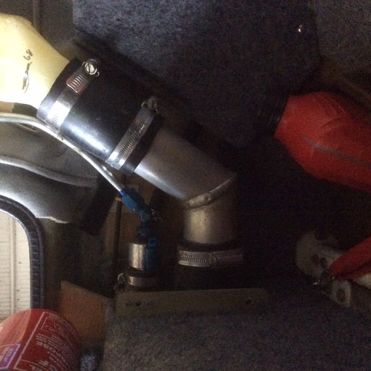

dpark748(at)me.com
PostPosted: Sat Dec 16, 2017 3:28 am    Post subject: LAA Airworthiness Alert. AIL December 2017 All Europas Reply with quote
[img]cid:2958E4B8-5B90-4D32-A257-A3B2D79E1C16[/img]
Simple and cheap did this three years ago without any problem
Dave Park
On 16 Dec 2017, at 11:19, GRAHAM SINGLETON <grahamsingleton(at)btinternet.com (grahamsingleton(at)btinternet.com)> wrote:
[quote]Best solution is to use short silicone joints to an aluminium elbow, it's much lighter and the silicone is less problematic regarding erosion etc.
Tim Ward organised a batch of nice elbows but that was years ago.

davidjoyce(at)doctors.org
PostPosted: Sat Dec 16, 2017 6:29 am    Post subject: LAA Airworthiness Alert. AIL December 2017 All Europas Reply with quote
Dave, a nice solution, but for those who haven't got a tame aluminium welder it might be cheaper to buy a flurosilicone lined angled fuel filler hose from carbuildersolutions.com and use a straight section of alloy tubing to make up the necessary length. Regards, David, G-XSDJ

[quote] Best solution is to use short silicone joints to an aluminium elbow, it's much lighter and the silicone is less problematic regarding erosion etc.
It wouldn't be difficult to weld one up?
Graham

I have seen an aluminium tube 45 degree solution on eBay at item number 300735817645 for less than £20. May be suitable.
Dave Watts
G-BXDY

On 2017-12-16 11:27, david park wrote: [quote]
<image1.jpeg>
Dave Park

PostPosted: Sat Dec 16, 2017 8:31 am    Post subject: LAA Airworthiness Alert. AIL December 2017 All Europas Reply with quote
The angle is nearer 60 degrees so I am not sure it would work.  It would be nice if it did.
Brian

Chaps,
This link has some interesting information on variations in “fluorosilicone” hose.
http://www.silflex.com/products/fuel-oil-applications.html
I will be looking for the term “profuel”.
Roger

Hi Ivor
Been looking for hose for a standard mod to replace the classic pipe with aluminium.  The only hose we have found so far that is guaranteed 100% for petrol is Samco ProFuel. Unfortunately it is on a 42 day lead time.
https://www.merlinmotorsport.co.uk/p/samco-profuel-silicone-coupling-hose-psch
Pete
