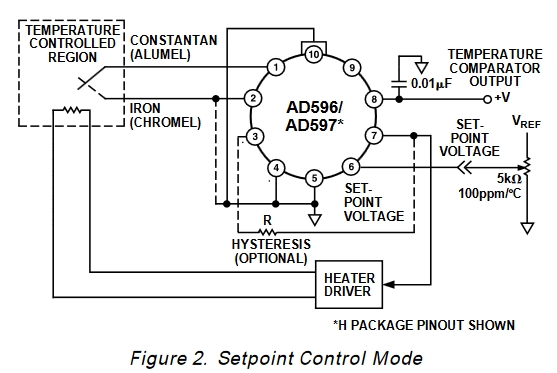

Another option uses the Analog Devices thermocouple
conditioners in a on-off switching mode.
https://goo.gl/7ufeaL
Here's a simplified schematic . . .
[img]cid:7.1.0.9.0.20180103113458.060890d8(at)aeroelectric.com.0[/img]
Instead of driving a heater control relay, one could
drive an LED indicator light directly from the
signal conditioner's output . . .
This would let you connect directly to the cylinder
head with appropriate thermocouple material.
