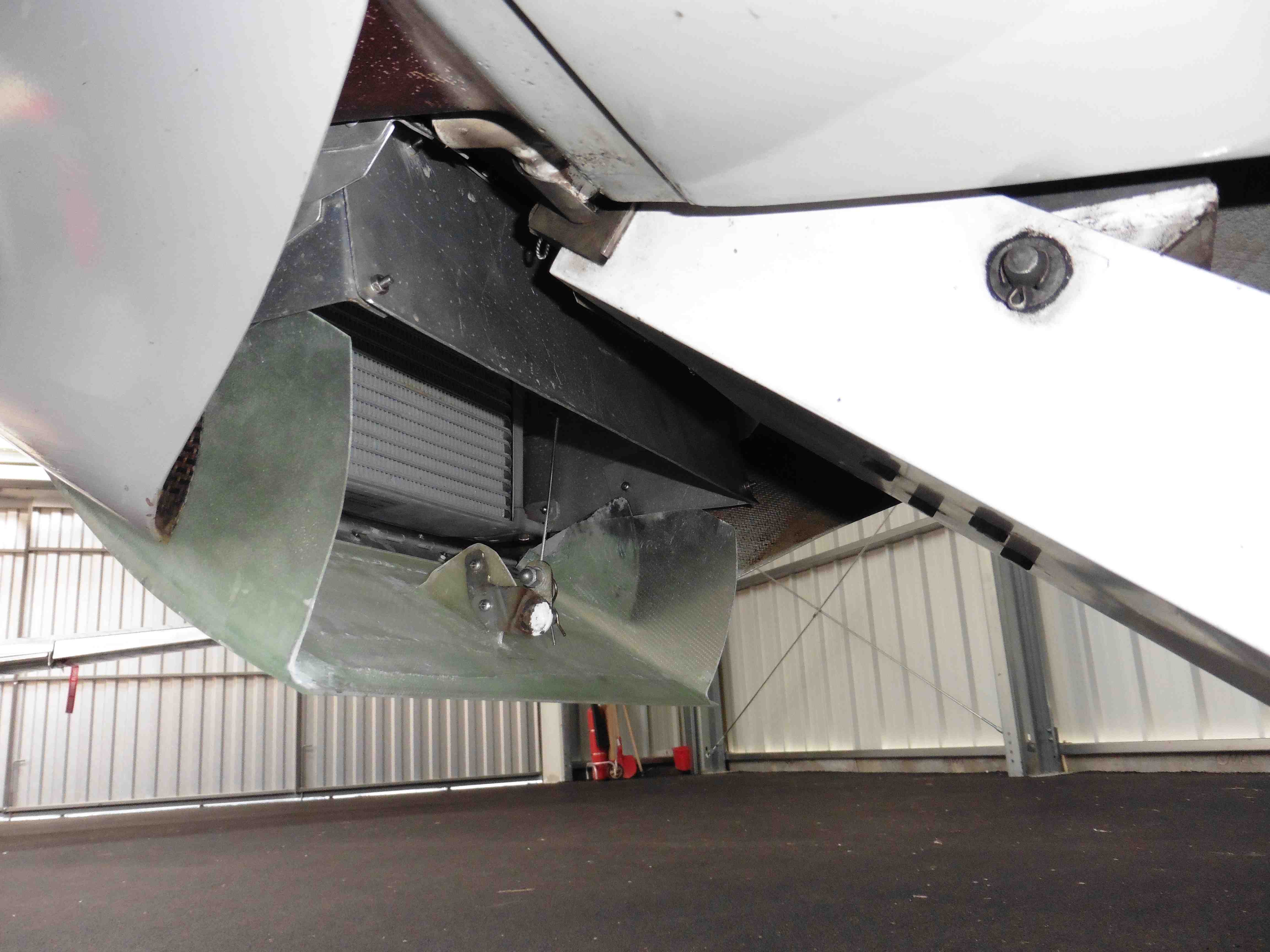

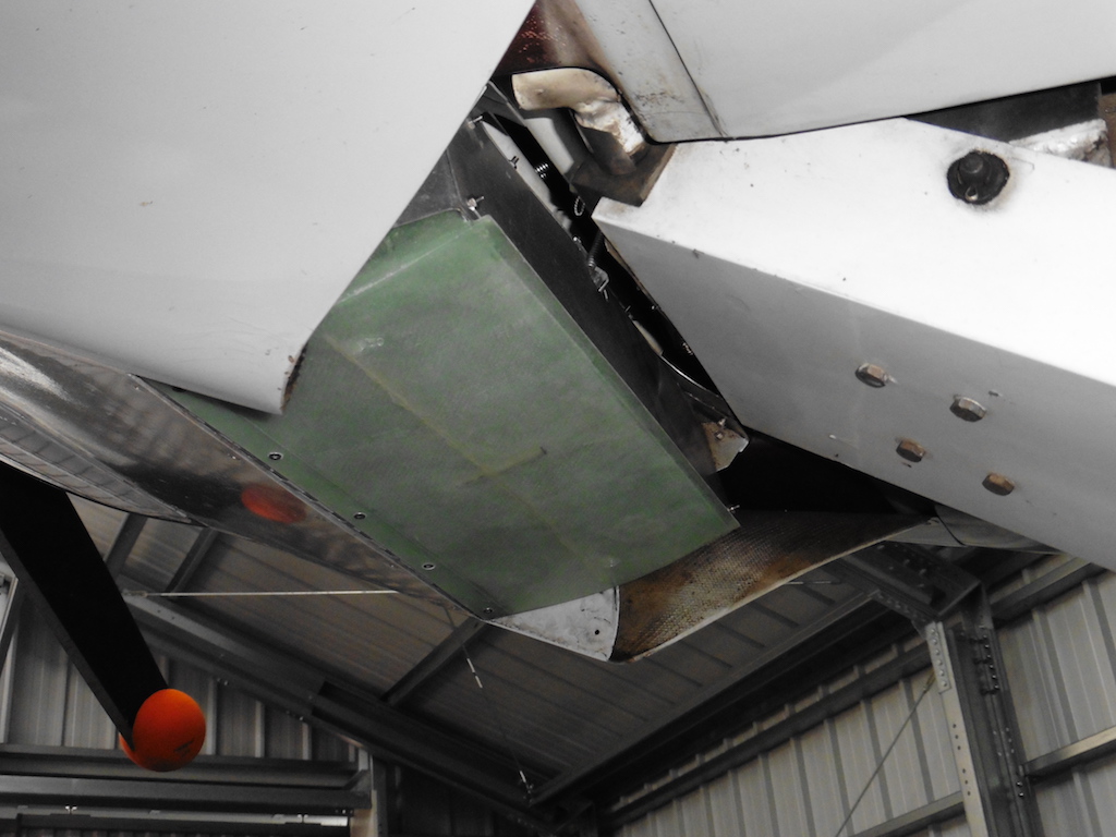

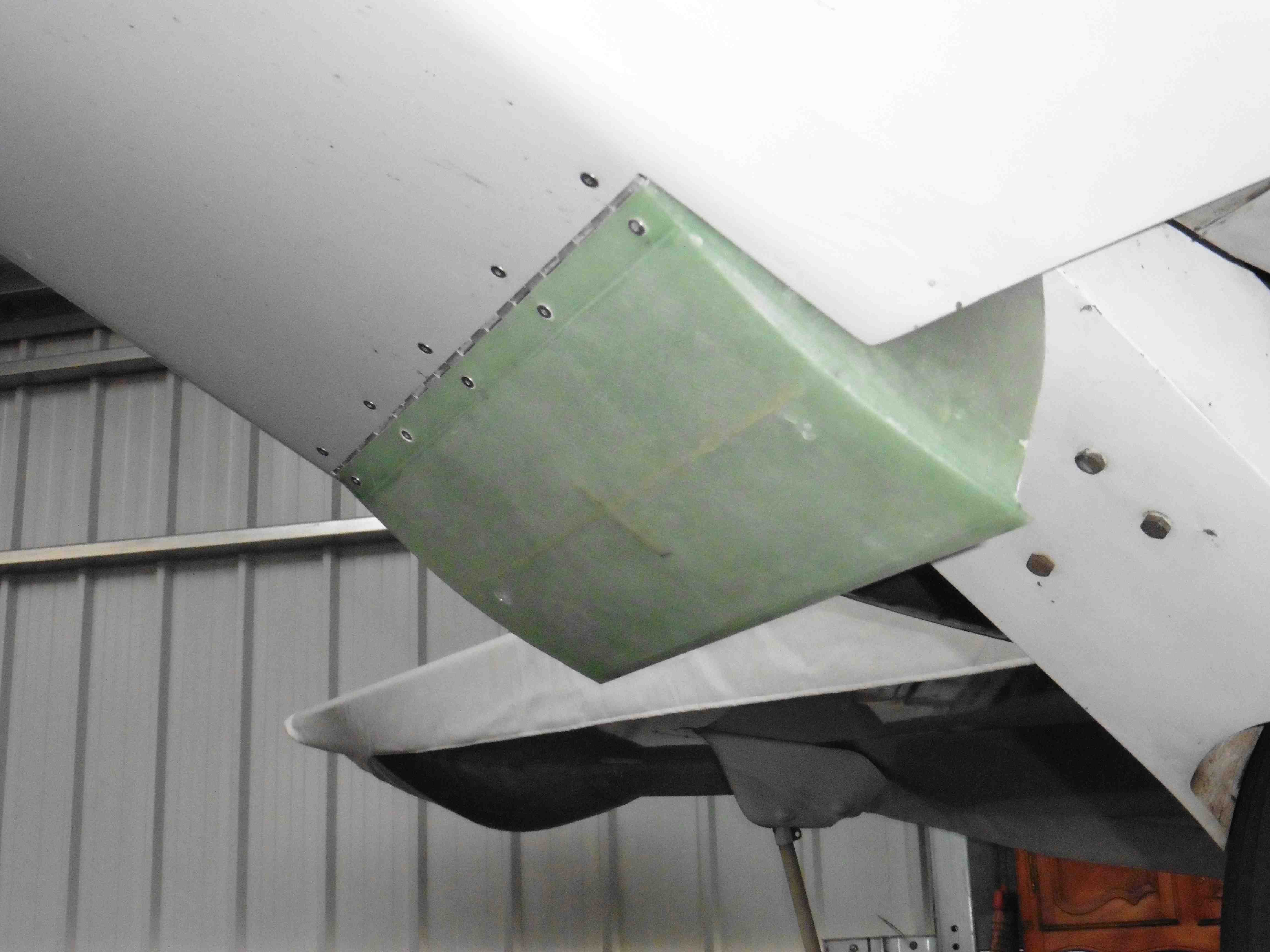

Remi Guerner
Joined: 14 Dec 2010
Posts: 284
PostPosted: Mon Jan 01, 2018 2:47 am    Post subject: Re: Engine Over-cooling Reply with quote
After experimenting for 16 years with the cooling of my Europa XS, I found that the best results are obtained with the installation of an effective cowl flap. The cowl flap does two things:
1. increasing the exit area of the cowl to improve the airflow through the radiators for a better cooling on the ground and during full power climb in summer.
2. Reducing that exit area to limit that flow and allow high enough oil and water temperatures at cruise especially in winter. For that matter, I found that a cowl flap is not effective unless it can reduce the exit area by at least 90%. Then the last few percents make a big difference. Additionally, the closed cowl flap accelerate the warm up of the engine and allows a very effective cabin heating in winter.
Attached are a few pics of my cowl flap configuration. The key features are:
a. The flap controls the airflow through the radiator+oil cooler exclusively. The flow entering the cowl through the round inlets is not affected by the position of the flap as it can escape on the sides and behind the flap. This allows to keep the heat sensitive accessories (battery, ignition modules, voltage regulator) and fuel system cool enough even with the cowl flap fully closed.
b. When the flap is fully closed, the only way for the hot air from the radiators to escape is through the 1-3/4" SCAT ducting to the cockpit (when the cabin heat flap is open) and the leaks. Therefore most of the hot air is forced to the cockpit. That makes the heating as effective as in a car.
c. My water radiator is a specially made one with two more rows (110 mm height) than the factory standard. This change was necessary to help solve the ground cooling issue. The oil cooler is still the 13 row Mocal that is covered 30% all year round and more in winter. I intend to replace it with a 7 row version with some more cowling work to further reduce drag. No thermostat.
Remi Guerner
F-PGKL
XS mono, 912ULS
 Filesize:  493.37 KB
 Viewed:  23299 Time(s)
 Filesize:  421.39 KB
 Filesize:  260.88 KB

Remi Guerner
Joined: 14 Dec 2010
Posts: 284
PostPosted: Mon Jan 01, 2018 8:33 am    Post subject: Re: Engine Over-cooling Reply with quote
Pete,
The present version of my cowl flap was installed in May 2016. So that is only the second winter with that configuration. It was tested down to about minus 5°C. At this temp I was using only one tens of the stroke of the heat flap control. When I have the opportunity to fly at lower temperatures, I will make some measurements.
Remi

PostPosted: Mon Jan 01, 2018 2:02 pm    Post subject: Re: Engine Over-cooling Reply with quote
Remi, that is a very clean setup and an Incredible effective cabin heater. I have a flap behind the oil cooler, but it's limit is about -5°C OAT at 80°C oil with normal clothing, especially at high altitude in the thin air. BTW many certified aircraft have this problem as well.
Roland

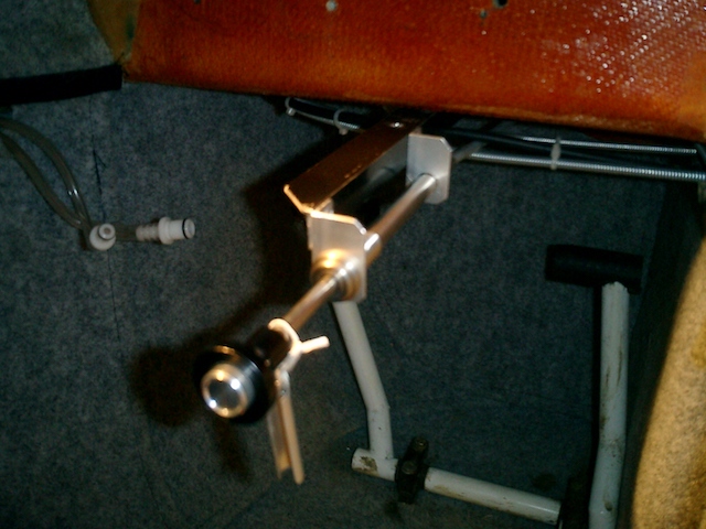

Remi Guerner
Joined: 14 Dec 2010
Posts: 284
PostPosted: Wed Jan 03, 2018 12:50 am    Post subject: Re: Engine Over-cooling Reply with quote
Fred,
The attached picture shows how the button lock push pull control (A700 from ACS) is installed below the instrument module and under the top of the pilot footwell. From there the casing makes 270° turn to the left and enters the tunnel through the right side of the foot well, then goes down vertically, following the firewall to the flap. A spring is not necessary as the natural aerodynamic forces tend to pull the flap open. When pulled fully closed however, the aerodynamic load is very high, so it is critical to build a very rigid and robust flap (hence the wing shaped profile of my flap). Otherwise the flap flexes under load and is not effective enough.
Remi

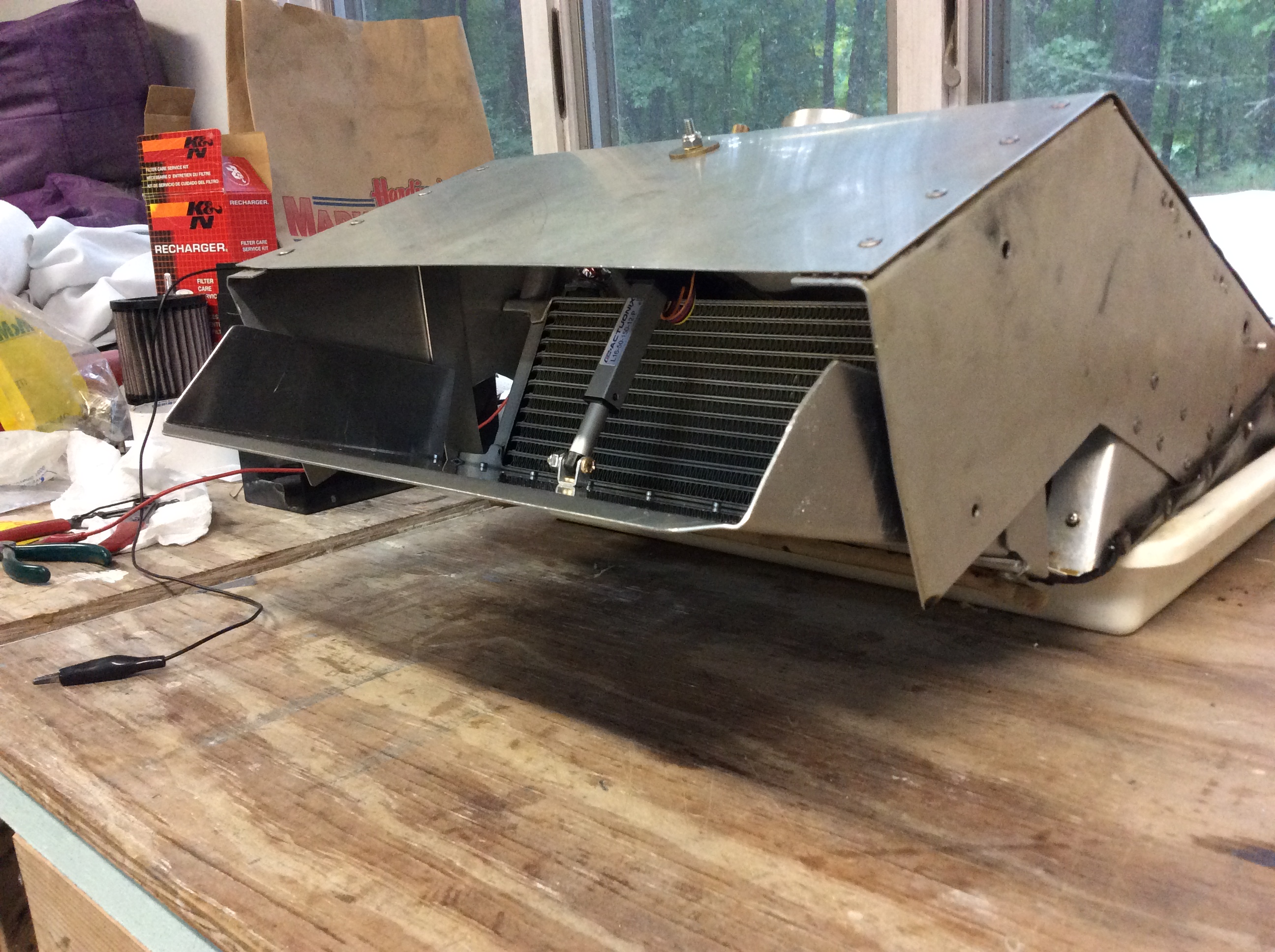

h&jeuropa
Joined: 07 Nov 2006
Posts: 656
PostPosted: Thu Jan 04, 2018 8:24 am    Post subject: Re: Engine Over-cooling Reply with quote
At Oshkosh 2016, Erich Trombley showed us the cowl flap he fitted. We have copied it and find it provides similar benefits as Remi described. The only difference from Remi's is that we use a electric actuator and display cowl flap position on our EFIS. The actuator is a Actuonix L16-50-150-12-P Here is a photo showing the actuator and the flap.
Jim & Heather
 Filesize:  1.41 MB
 Viewed:  23095 Time(s)
