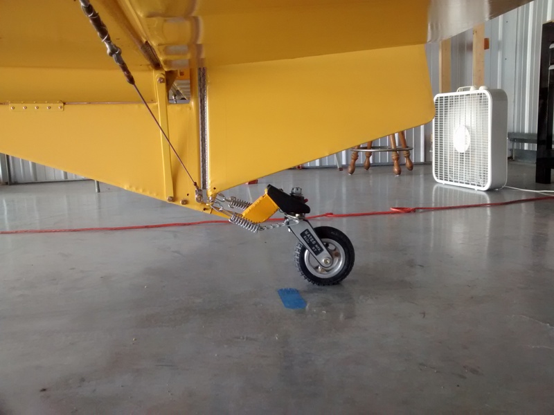

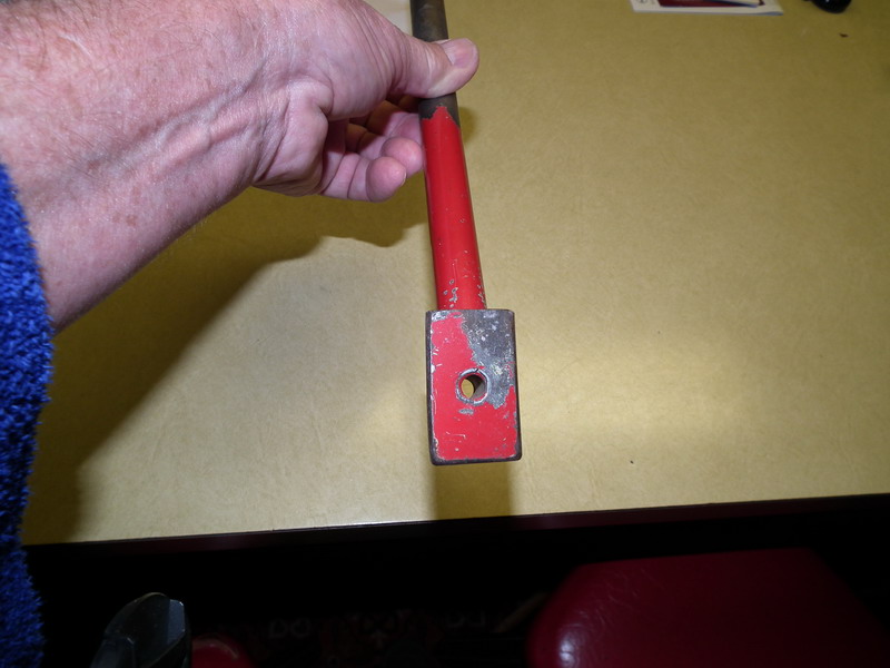

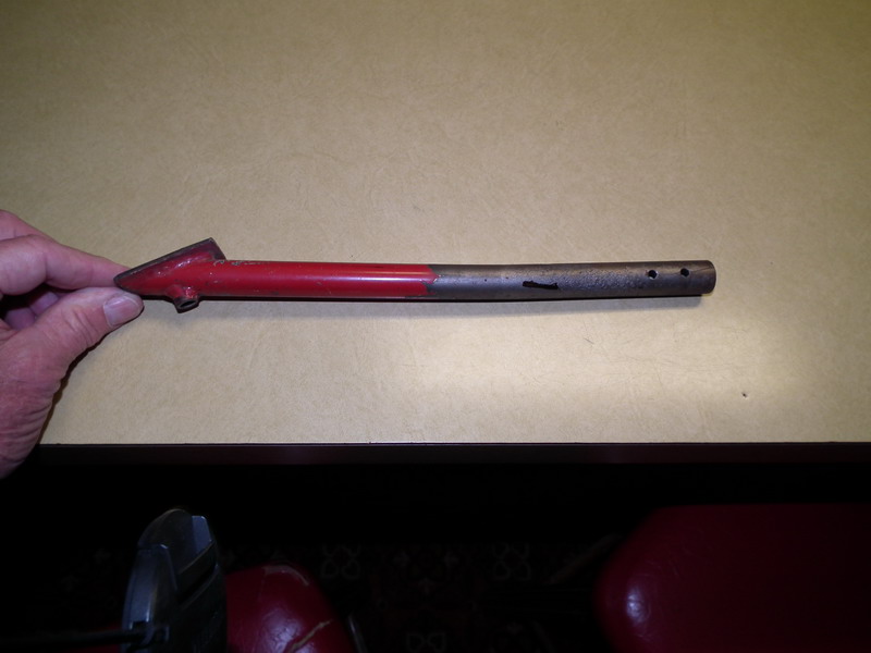

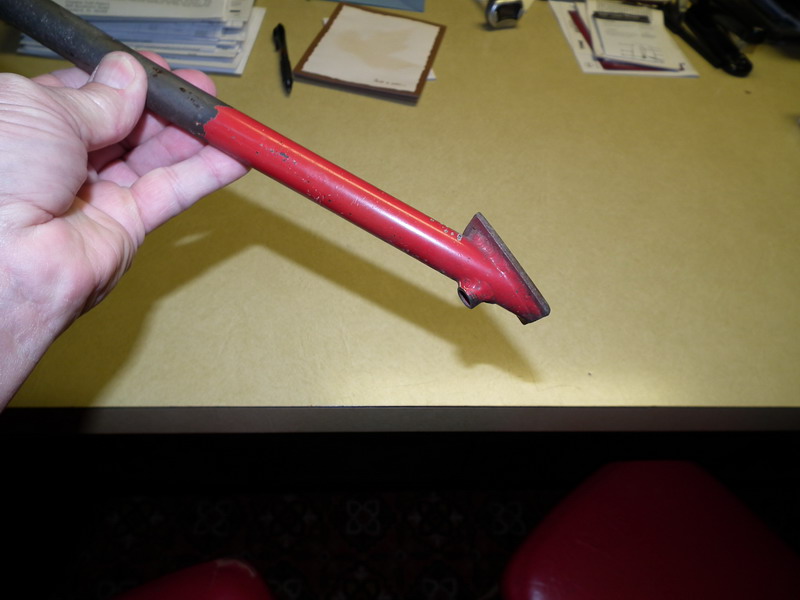

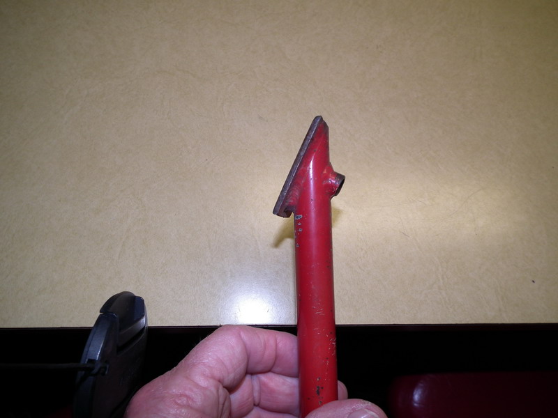

Tail wheel strut I use is 3/4" X .120" 4130 heat treat to 48 RC.
I'll see if I can find a couple photos to attach. I use mine with Maul 6" and 8" tail wheels. Can't remember the length, but think about 6" protruding from the tail post lower tube.
These are photos of an old strut I replaced some years ago.

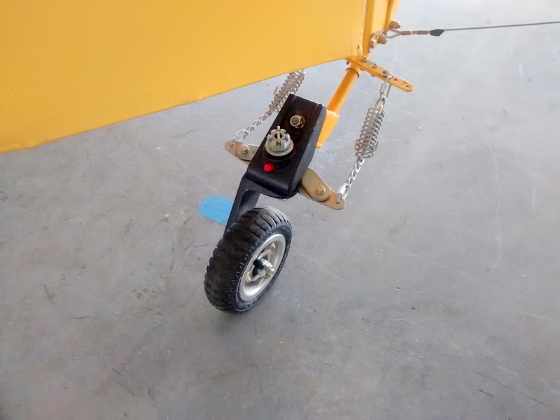

I replaced my aluminum rod which kept bending with 3/4" OD X .12" wall 4140 tubing from Aircraft Spruce. I used this with a 6" Matco pneumatic tailwheel. Has been working well. See attached pix's.

I can only speak from personal experience with steel tail wheel strut. Heat treated to 48 RC, the steel strut has performed much better than the aluminum or fiberglass struts.
Steel probably weighs about the same as the standard length 3/4" 7075 solid rod.
Difference in weight:
Steel tube: 3/4X.120X12" 4130 .807 lbs
Aluminum rod: 3/4X12" 2024T3 .529 lbs (Aircraft Spruce didn't list 7075 3/4" rod)
Steel 1.8 oz per foot heavier.
My tail wheel strut is less than a foot. Don't remember the exact length. The little plate and bushing increase weight. I don't know how much, but not much.
I have a Maule 8" Tundra Tail Wheel that I flew with for a period of years. Can't remember how much that weighed. Tail wheel and aircraft performed well. I took it off last time I flew to Alaska thinking I would get a little more speed with the smaller 6" Maule solid rubber tail wheel. Couldn't tell any difference. On one flight to Alaska I swapped my 8x6 tires for 6x6 to see if I could get a little more speed. No difference that I could tell.
I am not recommending anyone else use my tail wheel strut or any other changes I have made to my MKIII. However, sure has worked well for me and my style flying. I went to steel gear legs and tail wheel struts 32 years ago.

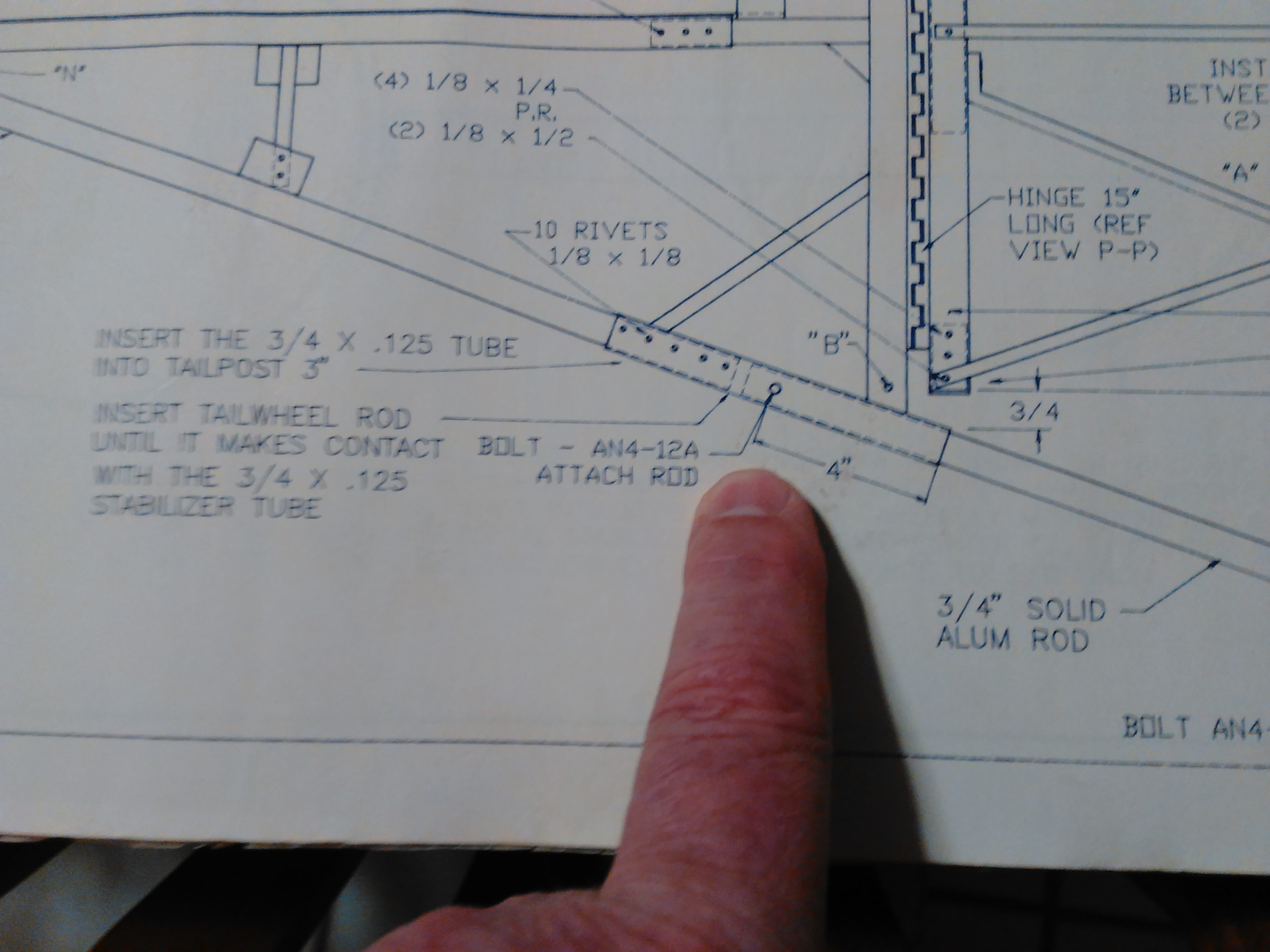

byoungplumbing(at)gmail.c
PostPosted: Sat Feb 17, 2018 8:51 pm    Post subject: Replacement tail rod...? Reply with quote
My plans show a 1/4 inch bolt  4 inches in from the end of the tail post.   See pic.

 Total length of the legs on my Firestar
 were 35.5".  The heat treater at the time had a 36"
 oven.  Here is a photo of them.
 Filesize:  1.39 MB
 Viewed:  23604 Time(s)

PostPosted: Sat Feb 17, 2018 11:59 pm    Post subject: Replacement tail rod...? Reply with quote
Thank you Boyd, I appreciate the clarification.
I have a set of plans where the tailwheel aluminum rod is shown as being epoxied into the fuselage. It is Sheet #4, dated 1985. I would not be surprised if the later versions of the plans were upgraded to show the bolt that Boyd posted.
My aircraft appears to be epoxied. I may put a bolt in it anyway to have a more secure attachment.
