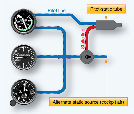

The alternate static source when switched with this type of (2 way switch) will supplement the original static source - not replace it.
A 3-way switch which selects from either Source A or Source B seems to be a requirement for some aircraft (l know this may not be applicable to the LAA).
Looking at the nice diagrams in FAA AMT Vol2 Figure 10-25 shows a 3-way switch. See attachment.
Is a 2-way switch acceptable?
 Filesize:  153.18 KB

John, I have attached the diagram I submitted to the LAA for approval of my Static/Pitot/AOA plumbing. The alternate static is cabin air from behind the Control Panel, to be used if the original source (under wing static) becomes blocked.
