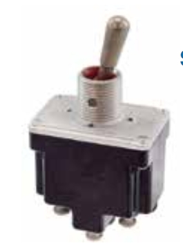

[img]cid:7.1.0.9.0.20180328075345.05fffc70(at)aeroelectric.com.0[/img]
Found a picture of this switch with the nuts
removed. You can see the end of the handle
shaft. Anyone who supplies this kind of switch
as a MilSpec device will probably have the same
feature.

PostPosted: Wed Mar 28, 2018 5:06 am    Post subject: Flap Switch Reply with quote
Pat:
If you LQQK into the switch where the 'bat' enters AND you see a rubber shield.  Those switches have a dust/moisture barrier and they do not rotate.
You can make the lever out of aluminum, hardwood or even use a 3D printer.
If you use set-screws do a little grinding on the bat to make a flat for the set-screw to bite into.
