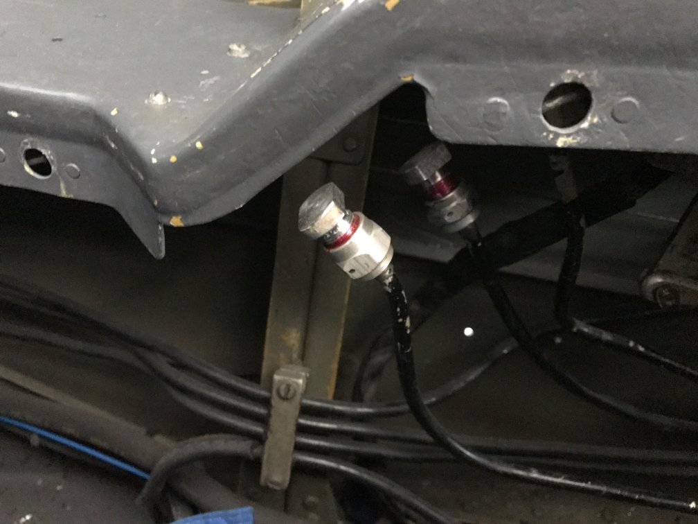

To the brain trust: I would like to remove the GIB flap control valve. I already did the GIB gear valve but replaced it with a block. Question: do the remaining three air lines have to be connected or can I just cap each of the three lines? It seems to me that I can just cap them since the air is coming from the front valve.

Gil I have done the same and just capped the lines
 Filesize:  97.67 KB
 Viewed:  9107 Time(s)

Thanks! Did you make those caps? If not, where can I get them?

No an aero engineering establishment in Australia did them.

I'm troubleshooting a flap issue this weekend. This idea really appeals to me. How do we get these plugs into our supply chain?

Plugs? Do you mean the fittings that screw into the flap selector? If so, have you tried Doug Sapp?  He typically has some or all of the fittings in stock.
