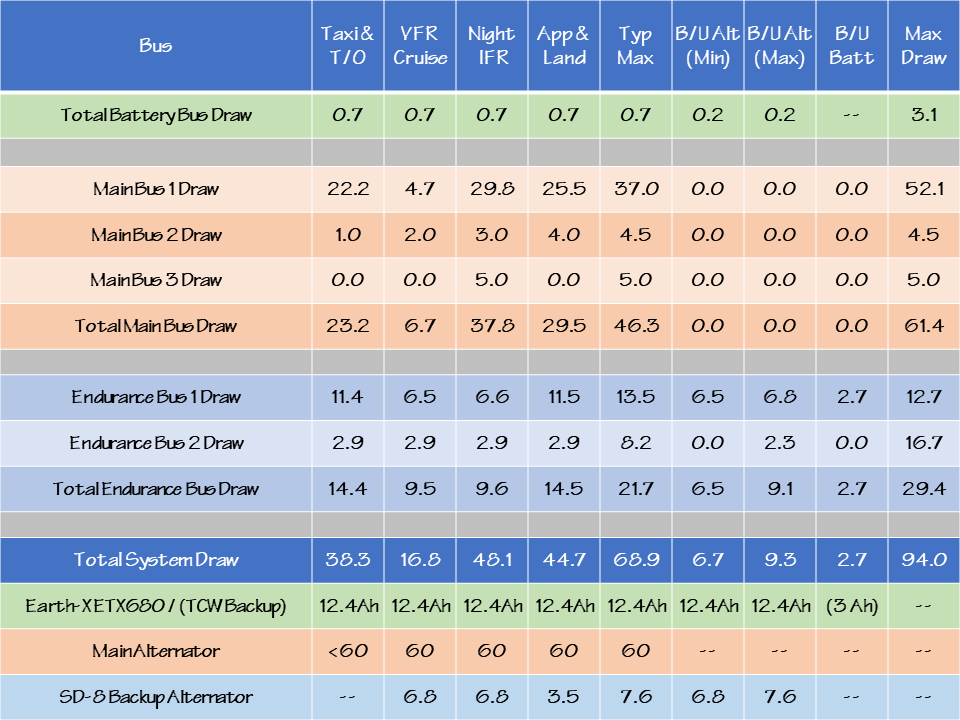

I've been working on the electrical architecture for my RV-8 and I'm getting close to a solution, but before I start buying and installing components, I'd like to get some feedback on my deign.
I'm planning an IFR-capable RV-8 with a Titan IO-370, dual P-mags and a Whirlwind constant speed prop. Avionics will be the G3X system with G-5, GTN-650, GTR20, et al. I'm planning to use the Earth-X ETX680 battery as the main, and a TCW 3 Ah backup battery. The main alternator will be a belt-driven B&C BC-460H (60 Amps) with a gear-driven SD-8 backup (<8 Amps).
I've read Bob Nuckolls book several times and I'm sold on two alternator one battery set up he described in Z-13. My architecture is based on that, and only has minor changes such as addition of avionics switch, dual P-mags, deletion of the low voltage package (G3X has that feature), and addition of a back-up battery.
Here's a link to my design: https://www.dropbox.com/s/2l10pzbcba4z4k7/Electrical%20System%20Overview%20%28v13.11%29.pdf?dl=0
I've come up with a battery buss, main busses and endurance busses. Main Bus has been divided into three: MB1 is fuses, MB2 is circuit breakers, and MB3 is a planned expansion of an additional fuse block. (I gave this block a load of 5 amps as a planning figure.) I won't construct it, but I will have a place to put it in case I need it in the future. Essential Buss 1 is fuses, and EB2 is CBs. I've mostly used fuses, except for a few items where I want to be able to use the fuse as an alternate means of disconnecting power to an appliance, or where the manufactures specify a CB.
I've worked tirelessly on my load analysis, and I think it's pretty solid. I've had to make some assumptions of appliance power requirements when I couldn't find the exact power requirements of a particular unit.
I've used the "Night IFR" load analysis for my continuous flow value, and "Typical Max" load as my intermittent flow value when doing my analysis for sizing wires, using figures 11-2 in AC 43.13 as a reference.
I welcome any comments, suggestion or critiques of my design.
Thanks for looking.
Rob

PostPosted: Tue Apr 10, 2018 7:48 am    Post subject: Re: Please critique my electrical design Reply with quote
Bob,
Thanks for the response -- it's a pleasure to dialog with you after having spent so much time reading and rereading your book.
The backup batter is a TCW IBBS-12v-3ah battery, and it's recommended by Garmin to keep the G3X and engine interface on through the voltage drop during engine start. Since the G3X is the only engine instrumentation I have, that seems like a key component.
My standby alternator is an SD-8, which I think is what you designed the Z-13/8T around, correct? It provides me with enough power for my en route phase except when transmitting on the radio with the autopilot engaged, but I think that's a reasonable tradeoff for the simplicity and value of the Z-13.
Your latest Z-13/8 didn't have dual P-mags on it, so I wanted to make sure what I've done is acceptable. I initially had both P-mags on my Main Bus 2, but another builder recommended splitting the sources for redundancy in the event of a main alternator failure, even though splitting their sources adds an extra wire run from the Battery Bus (near the battery) to the CB & switch. Given the length of that run, I thought it should have a fuse, even though the P-mag install instructions call for a 3A CB. I sent a query to Emag this morning to ask for their input on that and my current setup of fuse -- CB -- switch -- P-mag.
I also incorporated your suggested avionics switch for those who have to have one. I know you're not fond of CB switches, but I couldn't find a switch rated for 30A that wasn't a CB. Would a relay be better in lieu of the CB switch? (Main Bus 1 and Endurance Bus 1 are located a couple inches from each other.)
Thanks again!
Rob

PostPosted: Tue Apr 10, 2018 9:14 am    Post subject: Re: Please critique my electrical design Reply with quote
I heard back from EMAG today and they recommended the following:
The P-mags should be put on the main bus because we only require a battery for starting. After 800 RPM or so we switch to running off our internal generator and do not require an external source. In the event of an internal generator failure we would switch back to the external power (main bus). Be sure to do the minimum cut-out test to see where the ignitions drop off and note it so in the event of an alternator failure you wont run the risk of the having to low of RPM for our ignitions to continue sparking.
If you do put us on the battery directly you run the chance of leaving us on and draining your battery.
I've updated my design to put the P-mags back the way I initially had them and removed the Battery Bus fuse block once again. That leads me to a new question -- is a 30A inline fuse too large for that device? Should I use a current limiter instead, or a CB in the engine compartment?
Rob

PostPosted: Tue Apr 10, 2018 9:22 am    Post subject: Re: Please critique my electrical design Reply with quote
The main voltage regulator sense terminal (3?) should
connect to the to the main power bus and not share a wire
with the field current. The way it is connected now will
eventually lead to overvoltage conditions due to
increasing resistance as terminals and switch contacts
corrode over time.
The start switch does not need to be on a circuit
breaker. A fuse on the main power bus should never blow.
And if it did, there should be a good reason.
And the plane will be safely on the ground if and
when the start fuse does blow.
There should not be 2 fuselinks in series going to the
main alternator field breaker. One is good enough. The
second one is redundant.
Who knows if the aux alt 2 amp breaker will trip before
the 15 amps fuse blows. Maybe increase the fuse to 30
amps?
Consider doing away with the avionics switch.
Maybe the trim indicator and fuel gauge should be on the
endurance bus. They use very little power.

PostPosted: Tue Apr 10, 2018 4:55 pm    Post subject: Re: Please critique my electrical design Reply with quote
Thanks for the feedback!
corrode over time.
I just followed Bob's wiring on the Z-13/8, but I'll be sure to check that against the manufacture's instructions when I buy the voltage regulator.
I put the starter on a CB so I'd have an alternate way of turning it off in the event the starter switch failed closed. I suppose turning off the master would have the same effect though.
The distance between Main Bus 1 and Main Bus 2 was 6 feet, so I thought I needed circuit protection on it. Other builders advised me not to use a fuse for fear of nuisance trips. I've since moved the location of the CBs to the front of the instrument panel which has reduced the length of that wire run to less than 18". Does that length of wire need circuit protection?
amps?
I have to confess I'm don't understand the intricacies of that set up as well as I wish. Bob also recommends 30A inline fuse and I'm not completely sure why I have it shown as 15A. The manufacturer recommends a 10A CB as the feed into the main bus, but I opted to go with Bob's design. Or I attempted to! Confused
I know I'm in the old school here, but I want the switch function.
That's a good point.
Thanks again,
Rob

If you look at B&C's wiring diagram
https://www.bandc.aero/pdfs/LR3C_Installation_Manual.pdf
the voltage sense terminal 3 is separate from the field terminal 6.
Also look at Bob's Z-12.
_
One fuselink provides protection for everything downstream of it.
A second fuselink is not required. All the second one does is make
an unnecessary failure point.
_
The maximum of 6" rule of thumb for unprotected wires is not cast
in stone. It all depends on what dangers the wire is exposed to.
_
Circuit breakers are mechanical devices that take time to operate.
That time could be longer than it takes a smaller fuse to blow. A larger
fuse will be slower to blow in case of the over-voltage module shorting out.
The aux alternator fuse protects the battery. It will not hurt to use a 30
amp fuse. Z-13/8 uses a 20awg fuselink which will probably carry more
than 30 amps before the wire melts. The aux alternator output is self
current limiting and will never exceed 10 amps or so.

Joe,
Thanks again for you help!
I followed B&C's parts list, but when they switched it from a generic Ford regulator to the LR3C I didn't realize I should have used the Z-12 architecture for that component. Z-12 doesn't include a fuseable link or crowbar -- should I take those out? I put the LV Warn light back in my design for now like the Z-12 has, but I'm sure the G3X has an input for that, so a stand-alone light won't be required. I'll also have to figure out if I still need the Lo Volt Warn CB in that arrangement.
That makes sense now, thanks!
I updated my design this morning, and removed the second fuseable link.
I think Bob replaced the Z-13's fusable link with a 30A inline fuse on the latest version. I'm having trouble finding a suitable component for that. I know Bonanzas have several glass fuses mounted on the firewall just above the battery (near their current limiters) and I suppose I could do something similar if required.
Does anyone have a part number/vendor they could recommend for a 30A inline fuse?

Bob:
Let's get a show of hands...
How many Pilots out there have a LOAD tester?
I can't get owners to check their tires and you want them to load test a battery!
Granted!  This is a aero-electric email list and many are builders.  So, if there are fellows out there that do have a load tester I doubt that would cover the rest of the BUYERS that only purchased the plane and did not build.
What do you think would sell a plane faster:
'Oh, and this plane has Dual Alternators and Dual Batteries.'
Or...
'And every year at annual I Load Test the battery."
Barry
On Tue, Apr 10, 2018 at 4:44 PM, Robert L. Nuckolls, III <nuckolls.bob(at)aeroelectric.com (nuckolls.bob(at)aeroelectric.com)> wrote:
At 03:01 PM 4/10/2018, you wrote:
 With two alternators, why a backup battery?
​Because what if the battery fails?
G-5's can have the Garmin $150 TINNY battery or ​you can apply that money to a much larger second battery which will be big enough to start the plane and supply days of power for the G-5.  I have not installed the G-3,  but I have installed 2 planes with Dual G-5's (AI & HSI).  With dual G-5's in a certified plane you are required toÂ
have dual Garmin batteries...  That is $300 for a stinking 1 or 2 AH battery.  Yea, I would be very happy to install a second battery - a small one - With just enough to start the plane in a 24:00 DARK stranded situation. Â
Yea, happened to me one night.  No Fun!
Barry
  Was this in spite of a considered preventative
  maintenance program? What was the battery's last
  cap-check value before the failure?
  A battery that is watched and maintained as
  carefully as tires, belts, propeller nicks
  air cleaners and engine oil is very unlikely
  to fail. Dual alternators virtually assures
  you of engine driven energy in spite of the
  loss of one alternator.
  The rule of thumb for battery replacement
  in the TC world is when it falls to less than
  75% of original capacity . . . in the modern
  RG battery world, this means it probably
  still cranks the engine but is in substantial
  decline on an ever increasing slope to failure
  yet unlikely to go belly up away from your
  home hangar.
  Few light aircraft owner's manuals speak to
  affirmative-action maintenance programs . . .
  but I'd bet that top-billing in the cast of performers
  virtually all dark-n-stormy night stories that
  speak to battery failure is a beyond-service-life
  battery.
