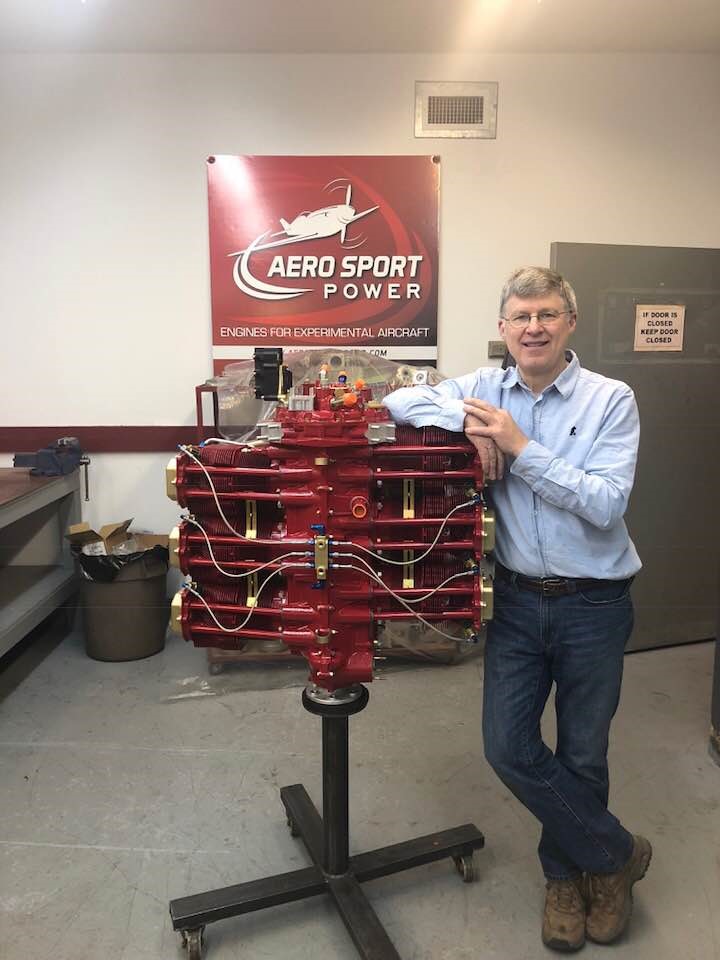

Hi
After a lot of thought I decided to order a *new* engine built from a Lycoming IO-540 kit by Aerosport Power located in Kamloops British Columbia Canada. As a Lycoming distributor they still have access to these kits.
I originally planned to get another engine from Barret Precision Engines (Tulsa Ok) which is where I got my first engine. They are great people BTW.
I went with Aerosport as the thought of a *new* engine was just too attractive.
An option that Aerosport provides is a "builder school" . Here you work one on one with one of their techs and assemble an engine from a large pile o' parts. When I inquired about the school they said you can do as much (or little) as you wanted.
I went to "school" on Monday am and was able to assemble 95% of the engine with the expert guidance of one of their techs (Simon). The crank was bolted to an engine stand and the con rods were installed. By lunch we had installed the bearings, crank & cam in the case, installed lifters, nose seal and mated the case. I was amazed at how tight the case through bolts were (necessary to prevent fretting). I large hammer (maul?) was used to drive them into place.
The assembled case was reattached to the engine stand. Then, after lunch the jugs were installed. This was a complete non event. Lots of LubriPlate and the correct tool to compress the rings and they simply slid into place.
Push rod tubes were installed along with the accessory case and cold air induction air box.
The next day he engine was completed. This included the push rods / rockers / injectors / fuel block / induction tubes etc.
Day three involved installing the engine on a test stand. This was fairly complex as I am using the SDS EFI/EI. There was a ton of wiring to install but it all went quite smoothly. At the end of the day the first two engine ruins were performed. The engine started quickly. I expected a cloud of black smoke based on all the assembly lubricant used but I only got a small initial puff of white smoke. The engine started in 2 or three seconds was smooth and strong.
On the morning of day 4 the final two engine runs were performed. After that the engine was removed from the test truck and prepped for palletization. This included installing by accessories (Denso alternator / 90 degree oil adapter / backup alternator etc).
The engine was put on a pallet and then crated. Today I drove home with the engine.
There were a few gotchas that Aerosport handled with ease.
1. I was using Barret's Cold Air Induction system on the engine (Barret was quite happy to sell it to me without an attached engine!). At the end of day 1, when torqueing one of the studs, it started to pull out. I spoke to another of the techs (Rob) who said no problem. I pulled the box and he installed a helicoil and that was that.
2. The Barret CAI system was new to Aerosport. They didn't realize that the induction tubes needed welding to the flange adapters. No problem - they had a local welder come in the next day and he did a very nice job.
3. The CAI system required induction tube flanges with deeper recesses than the flanges that came with the engine kit. Darryl found the required flanges and had them painted in very short order.
What I really liked is that everyone involved in my engine (even peripherally) were very approachable. For example, the chap (Stephen) who painted my engine and flywheel asked if I really wanted to leave my CAI system in green (I said I did). He then pointed out that the green was zinc chromium and was not really *paint*. Based on his recommendation I asked him to paint it – I was in Ferrari red by the next day. He could have easily just shrugged and walked away but he made sure I knew the implications of what I asked for. I really appreciated that.
I more or less had the run of the shop and was free to chat with everyone there. At no time did I feel limited. All my questions were answered and at no time did I feel rushed. As I was hands on all through the process I really learned a lot about the engine and how it operates. Based on the course, I would have no problem swapping a jug (provided I had the right tools).
I would also like to give a shout out to B&C. I had purchased a standby alternator that I planned to install at Aerosport. During the install it became apparent something was amiss. I spoke to TJ at B&C who con firmed there was a problem with the alternator supplied. Less than 24 hours later FedEx had delivered a replacement. Things can and will go sideways at times. A measure of a company is how they deal with these situations. B&C could not have been better.
Another shout out should go to Ross and Barry at SDSEFI. Their Electronic Fuel Injection and Electronic Ignition system is a work of art and performed flawlessly. I look forward to flying behind it.
To close on the school, the only things I did not do was install the nose seal, silk thread the case halves and adjust the push rod lengths. Each of these operations I wanted to be done by the most expert of hands. I did pretty much everything else. During this, Simon was great at gently pointing out my mistakes so I could correct them.
In short, the build school was well worth the price of admission. The Aerosport people were all very pleasant, approachable and knowledgeable.
Pix of my Aerosport go fast engine is attached!
Cheers
Les

Neat experience. I have an io-375 from Aerosport. Found them great to
deal with. One thing to check based on the picture. I believe Lycoming
has a SB out stating that the fuel lines to the injectors should be supported
with Adel clamps.

I agree on the injector lines. All of that will happen when the engine is installed. I want to change a couple of the lengths so things are a bit neater.

Just to be clear, not only is there a Lycoming Service Bulletin on fuel injection lines and clamps, there are a number of ADs, most recent is
AD 2015-19-07. Clearly something to pay attention to, regardless of where you sit on the E-amateur built vs AD compliance debate.
The service bulletin shows you exactly where Lycoming thinks the clamps should be.
