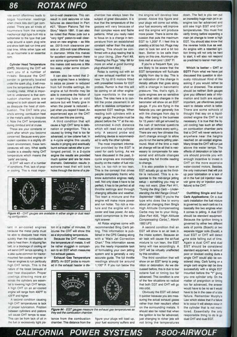

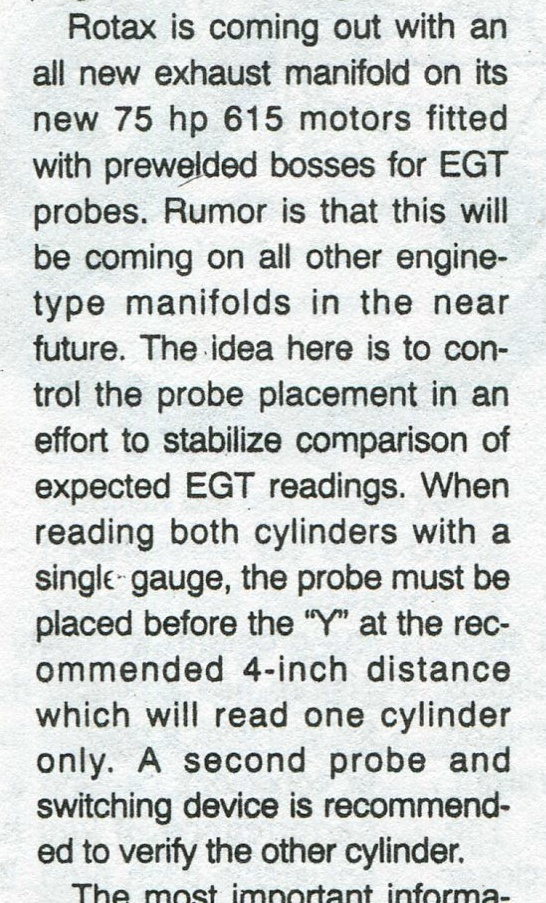

Digging into the 2005 CPS catalog, on page 86 of their Rotax Info pages, I found this info on EGT probes starting at the bottom of the 2nd column and getting pertinent in the middle of the center column, and if I read it right (?) the probe ought to be 4 inches from the piston wall.
The 2nd image is a blowup of the pertinent section.
FWIW, I went out to the hangar and the factory installed EGT bosses on the 582 are 1 5/8" away from the end of the exhaust port flanges, which would probably put them 4" out from the piston wall, so that agrees.
