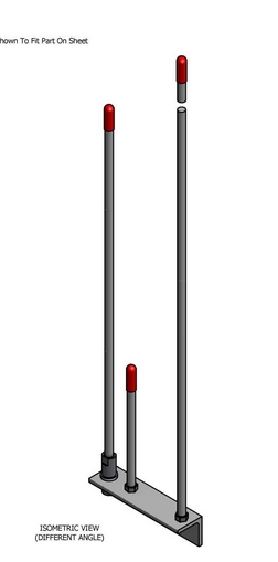

As far as non-metallic paint on antennas, I wonder if that’s a detuning effect because of changing the dielectric...
A valid hypothesis I think. I've been supplying
antennas to folks in the local prescribed burn
and fire fighting associations. There's a
product sold on eBay fabricated from 'ladder
line' that performs as a dual band (VHF/UHF)
antenna. I housed one in a piece of 1" thinwall
pvc but disappointed to find that the center
frequencies moved down about 10%.
The antenna was 'snug' in the pipl.
Tried a piece of 2" and things got
better . . . ~5% downshift. Hmmm . . .
getting ready to try a 3" piece with
spacers designed to hold the antenna central
to the radome. I'm betting this is going
to be 'the answer' but not the solution.
Wind-loading for so large a radome complicates
the support structures. I can use this antenna
on the little antenna farm on my roof but not
on top of a 30 foot mast in the Kansas winter
ice and all the time winds. I've ordered materials
to built all metal dual band antennas of this
configuration.
[img]cid:.0[/img]
No radome necessary.
So I think your dielectric proximity idea is not without
merit . . .

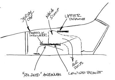

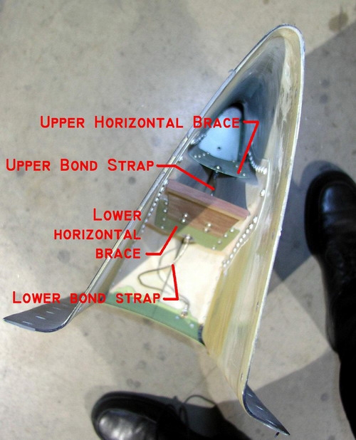

I'm recalling a bit of a fire drill on the ELT
transmitters for Beechjets where a new version
of the ELT kept tripping off due to high SWR
on the VHF antenna. Seems the older version happily
existed with a pair of antennas tucked under
the fairing at the root of vertical fin leading
edge.
[img]cid:.0[/img]
Oookkaaay . . .
Now, let's lay the VHF antenna back so that it
sorta conforms to the inside of the fairing . . .
except . . .
Fairing was also part of an air-intake ductwork
for the A/C . . . so the antennas wound up
looking like this:
[img]cid:.1[/img]
There were metallic braces inside the
fairing along with bond straps that tied
the braces to airframe . . . for lighting
effects. Added on top of all this was a
composite fairing material . . .
capped off with paint often chosen by
the customer hence of uncontrolled pedigree.
What's a poor ELT transmitter to do?

I couldn't find anywhere in the archives where
this installation had been measured for
performance . . . a condition that didn't
raise its ugly head until a new ELT complained
about an 'unsatisfactory' antenna.

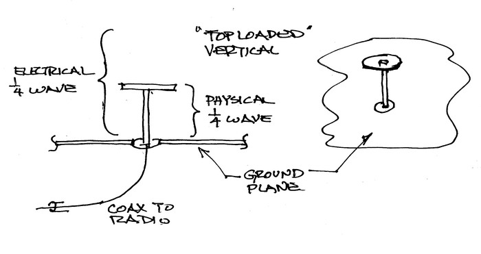

I suggested we design a new, top loaded vertical
for the VHF antenna that remained vertical with
better separation from the effects of overhead
structures.
[img]cid:.3[/img]
Further, we could fine tune the antenna to accommodate
any residual effects from proximity of other structures.
This got the flying fuzz all in a dither . . . a new
antenna would violate the TSO on the ELT . . . but
abusing the TSO'd antenna did not . . . go figure.
I think they wound up widening the SWR trip tolerances
on the ELT transmitter.
Not one of my happier experiences with the bureaucracy.
edge.
<25ac6ff7.jpg>
Oookkaaay . . .
except . . .
looking like this:
<25ac7006.jpg>
structures.
<25ac7026.jpg>
