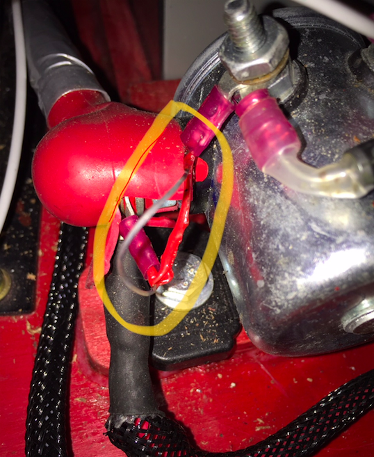

Then... I set master switch ON. and I see a light... it was not a light it was a wire on the battery relay that it was on fire, melting completly his insulation.

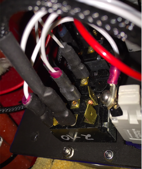

my master relay switch :
http://www.bandc.aero/toggleswitch-doublepole.aspx
After that I investiguate quickly, and I find that I set the polarity on the wrong way. I set it in the good one.
Same result ! Wire coming red without no more insulation.

- my IFF/Radio/electronics ignitions and all the electronics parts are good to the bin ? (I have a Trig S mode... new electronics Ignitions) wire like the Z19 with a diode and without avionics switch like the Z19.
- Why I have in the bad polarity, but also in the good this wire that is comming hot and red ?
