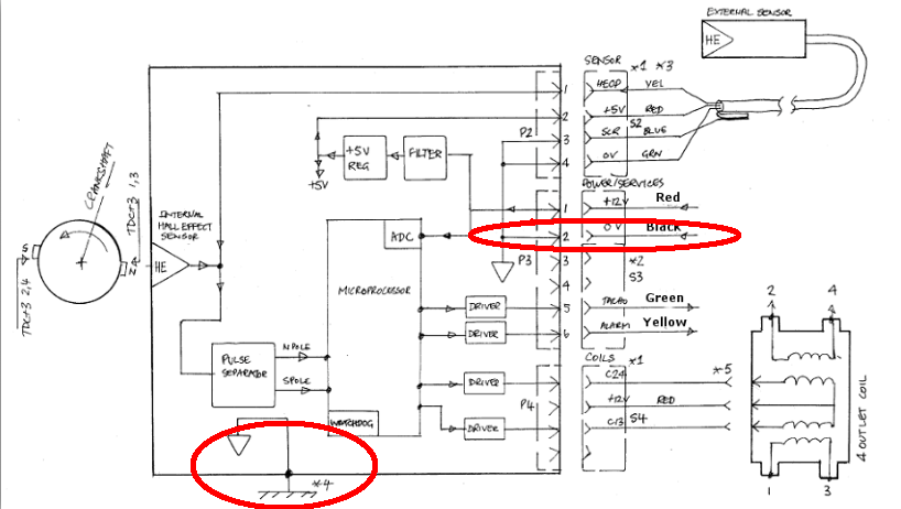

I was thinking about one things. My ignitions have the case grounded and have the ground wire, both are grounded on the ground buses. I don't have short cut the ignition module ?
