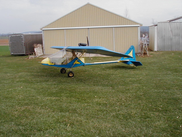

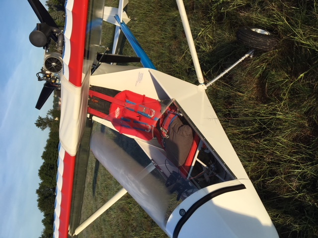

Finishing up the repairs on the Firefly nose bowl, next comes the windshield. The minimal windshield we had on it before was not very good. We would like to see other options for windshields for the Firestar / Firefly, hopefully this next time we can come up with something that works better to keep the wind buffet in your face to a minimum.
Thanks - Richard & David

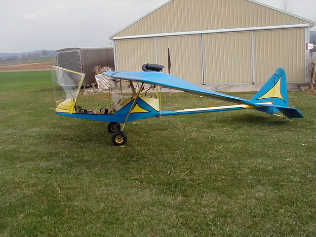

This is about is simple and light as it gets Richard. It simply flexes open and locks down with a prop rod and old fashion door latch. It’s .060” Lexan.

Yeah, that's what I had in mind! Do you have any other pictures of how it latches in place at the front and the back?

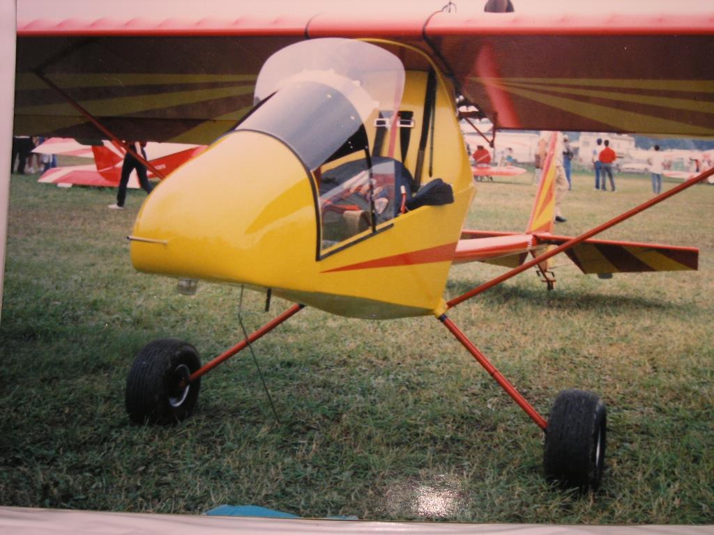

PostPosted: Sun Sep 09, 2018 3:06 pm    Post subject: Firefly / Firestar windshield Reply with quote

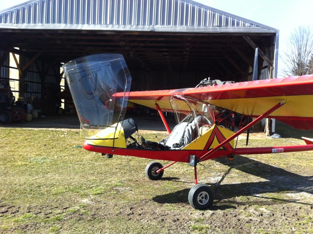

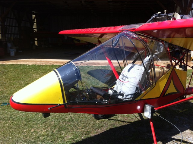

This is what I used on my FS. Normal windshield with a faring. Worked
good. Could wear a base ball cap and my eye glasses without goggles.
Before, the wind hit me right in the face.
Photo attached.
John h

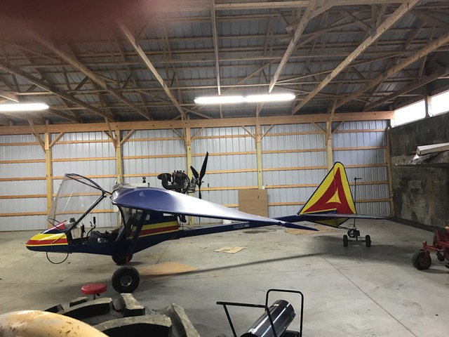

Me too. I installed a fixed windshield after speaking with John H, and it is indeed more comfortable, but getting in and out of the aircraft is quite a spectacle. If anyone has details of a good safe latching system that allows easy entry/exit I'd love to see it.

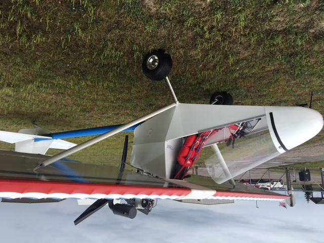

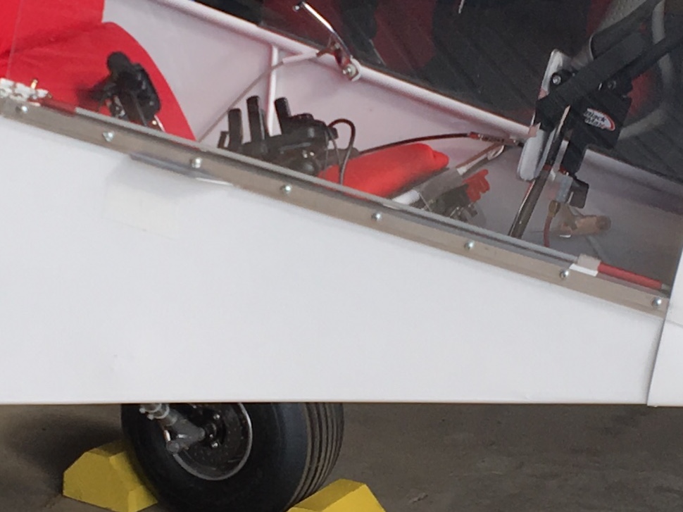

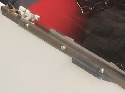

PostPosted: Mon Sep 10, 2018 4:51 am    Post subject: Firefly / Firestar windshield Reply with quote

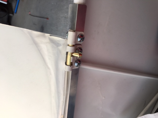

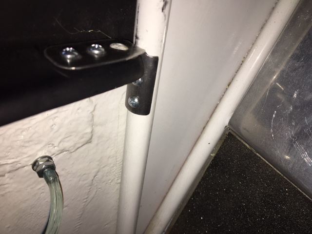

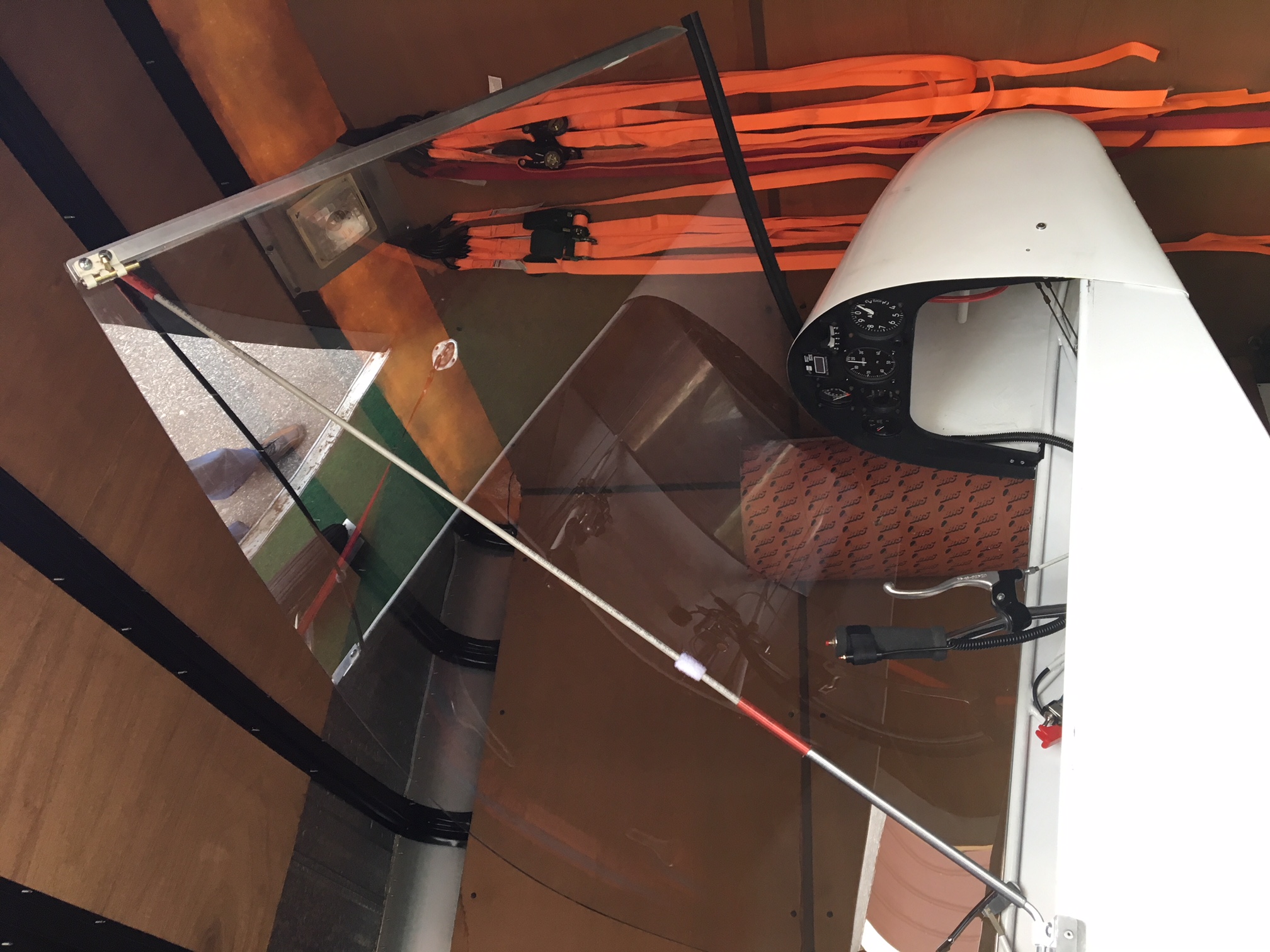

Hi Jerry. I sent a few pictures to Richard Pike yesterday. Maybe he’ll share. It’s very much like my flexing MKII was . It uses a simple old fashion screen door locking latch with great.
George H.

gdhelton(at)gmail.com
PostPosted: Mon Sep 10, 2018 5:21 am    Post subject: Firefly / Firestar windshield Reply with quote

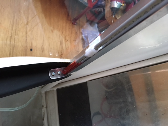

That’s “works great “. This last picture shows it held open by the two piece prop rod which also locks the front of the down.

PostPosted: Mon Sep 10, 2018 10:13 am    Post subject: Firefly / Firestar windshield Reply with quote
Dang George, that looks pretty simple and slick! The system you use LOOKS just like the system that Larry C described to me on his FS2. Nice clean installation.
I am ASSUMING that you swing the windshield over and "plug in" the front pin, then latch the rear pin? Or do you have a double-pin latch that engages both front and rear pins at the same time?

PostPosted: Mon Sep 10, 2018 10:38 am    Post subject: Firefly / Firestar windshield Reply with quote
The latch and prop are what holds everything down and locked. The prop rod simply lays down and inserts into the little chronology steel fitting on the nose pod. It’s hinged at the rear latch by a piece of plastic fuel line.
PostPosted: Mon Sep 10, 2018 11:39 am    Post subject: Firefly / Firestar windshield Reply with quote

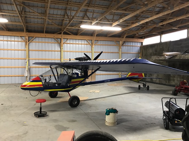

The canopy rail on the entry side is a piece of aluminum U channel that measures 3/4” on the inside so it just fits over the cockpit frame rail. It has some foam window strip to keep from damaging the fabric. The Lexan sandwiches between the U channel and piece of aluminum L channel. I used 8-32 screws that I cut down so they wouldn’t damage the fabric also. I cut most of one side of L channel down to just make a small entry handle. The hinge side( just flexes open) is a piece of aluminum L channel with the Lexan sandwiched between it and 3/4” aluminum strip with aluminum rivets.You use the prop rod during entry then fold it down to attach it on to the aluminum channel with a small piece of Velcro then flex it so it slides into that little steel fitting at the nose pod. That holds everything in place. The original Firestar is a lot harder to get into then the Firestar II.
I got all this aluminum channel from the Home Depot.
I’ve got 145 hours on this system so far. The only down side is it shakes a lot when taxiing on rough grass. It’s smooth as glass in flight. If you want to see it in action go to my YouTube channel and check out some of my videos.
curiousgdh is the channel.

<image1.jpeg>
> On Sep 10, 2018, at 2:13 PM, Bill Berle <victorbravo(at)sbcglobal.net> wrote:
> Bill Berle
> www.ezflaphandle.com - safety & performance upgrade for light aircraft
> www.grantstar.net - winning proposals for non-profit and for-profit entities
> On Mon, 9/10/18, George Helton <gdhelton(at)gmail.com> wrote:
> Subject: Re: Re: Firefly / Firestar windshield
> To: kolb-list(at)matronics.com
> Date: Monday, September 10, 2018, 6:20 AM
> Sent from my iPhone
>> On Sep 10, 2018, at 8:51 AM, George Helton <gdhelton(at)gmail.com>
>> <image1.jpeg>
>> <image3.jpeg>
>> <image4.jpeg>
>> <image5.jpeg>
>> George H.
>> Firestar
>> Mesick, Michigan
>> Sent from my iPhone
>>> On Sep 10, 2018, at 4:57 AM, Jerry-TS-MkII <12flybellaire(at)gmail.com>
>>> Say if you guys have some good photos of
> windshields and/or latches please post them here. I'll
> be trying to figure this one out on mine before long.
>>> Thanks, Jerry
>>> Read this topic online here:
>>> http://forums.matronics.com/viewtopic.php?p=483065#483065

Eugene Zimmerman
Posts: 392
PostPosted: Mon Sep 10, 2018 12:34 pm    Post subject: Firefly / Firestar windshield Reply with quote
Here are some picts of my "old man easy access" wind screens that I have made on my various Kolb planes over the years.
[img]cid:F1658E08-BE1B-4A77-80CF-706EF68217CB(at)PK5001Z[/img][img]cid:108C8E4C-1AFA-4EDE-BD48-622B60C3CC7B(at)PK5001Z[/img][img]cid:8FC9E8AF-7005-406A-A46C-ABB5A9134AD7(at)PK5001Z[/img][img]cid:4A0EC303-1527-4096-AD2F-AB1945BEB615(at)PK5001Z[/img][img]cid:0978F92B-24E0-4BDB-A105-634D98D33FB8(at)PK5001Z[/img][img]cid:EBC6C532-AF96-47EF-AD53-0FF0B5CA5E01(at)PK5001Z[/img]
 Filesize:  104.71 KB
 Viewed:  29008 Time(s)
 Filesize:  130.87 KB
 Filesize:  99.88 KB
 Filesize:  104.67 KB
 Filesize:  126.85 KB
 Filesize:  121.38 KB
Arty Trost
Joined: 25 May 2006
Posts: 206
Location: Sandy, Oregon
PostPosted: Mon Sep 10, 2018 1:17 pm    Post subject: Firefly / Firestar windshield Reply with quote
Gorgeous planes, Gene.
Arty Trost
Sandy, Oregon
"I refuse to tip toe through life just to arrive safely at death."
On Monday, September 10, 2018, 1:42:59 PM PDT, Eugene Zimmerman <etzimm(at)gmail.com> wrote:
[img]cid:isxkoWkRDUAW3LMAB3A3[/img][img]cid:vcNGidlkZft7lXpZIf1W[/img][img]cid:jAZCkz04n1FNiyecWpK8[/img][img]cid:qoBKbTaqTljbnUI8sQzL[/img][img]cid:5Le6lKJYK0GWhyIugcDf[/img][img]cid:vg87XeTSnV6SU3qdFN24[/img]
 Filesize:  130.87 KB
 Viewed:  29007 Time(s)
 Filesize:  104.71 KB
 Filesize:  104.67 KB
 Filesize:  99.88 KB
 Filesize:  121.38 KB
 Filesize:  126.85 KB
Richard Pike
Posts: 1671
PostPosted: Mon Sep 10, 2018 1:57 pm    Post subject: Re: Firefly / Firestar windshield Reply with quote
Eugene: do your flip up canopies latch in the back, or does gravity just hold them in place?
