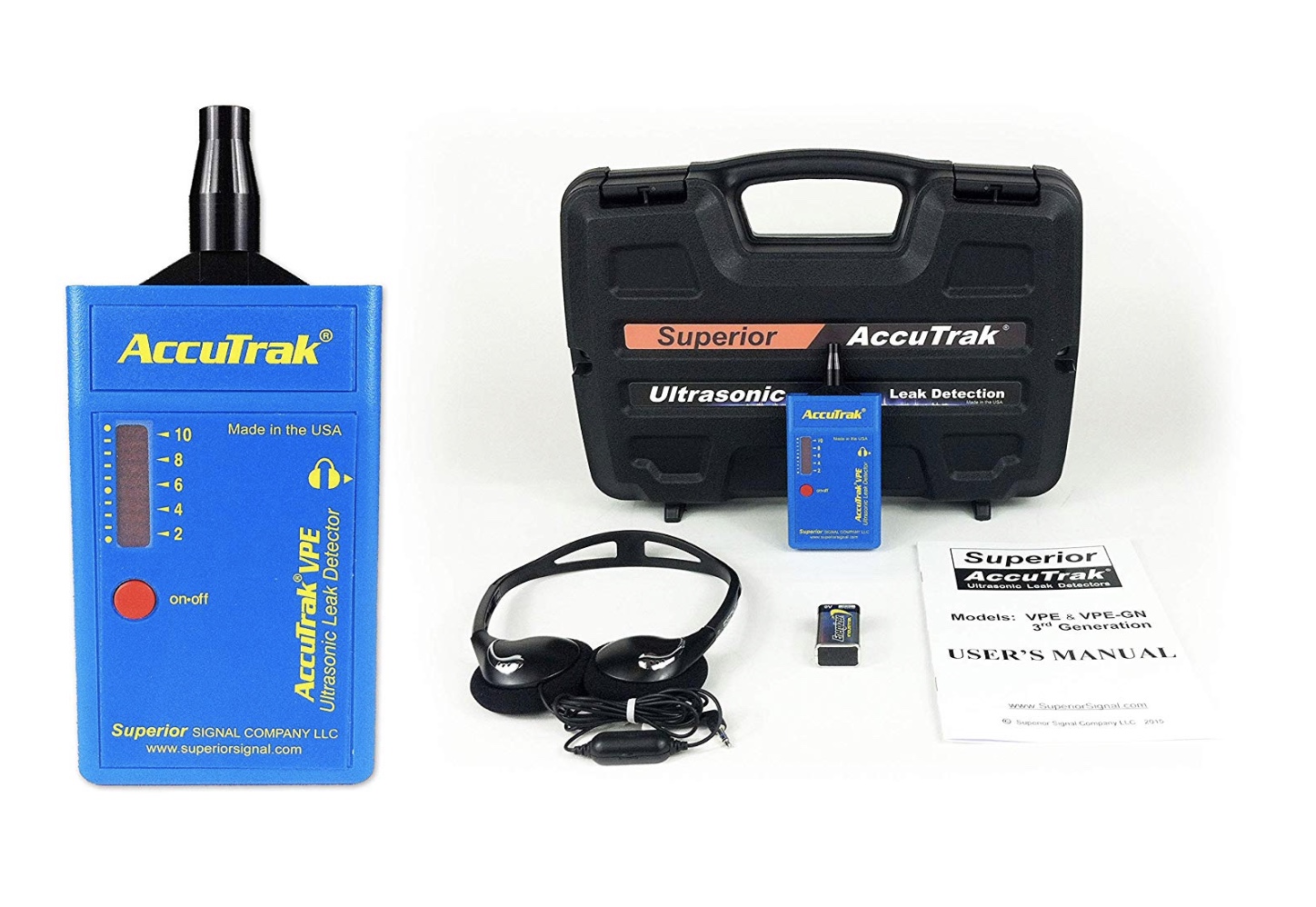

Another way to find leaks is to use a hand held ultrasonic leak detector. We have four CJs in one hangar and this piece of equipment is shared by everyone. It’s capable of uncovering even the smallest leak. And a large leak sounds like a hurricane. Here's an image of what we use. Worth every penny when a pneumatic system starts acting up and the cause is not obvious. These are available on Amazon.
Warren Hill
