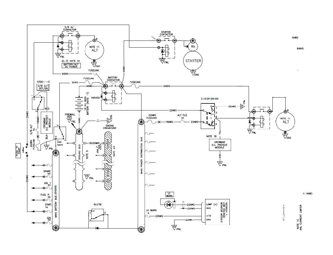

Assuming this the one for electronic injection electrically dependent engines, is there any merit in a separate bus for the engine? I'm trying to do this in my auto-conversion powered RV-7.  My desire and logic (or what I hope is logic Smile ) is that the airframe can go dark and the engine will still run, with an alternator charging the battery. I'm trying to mimic what you see in a 'typical' airframe with a magneto ignition a/c engine, where the master can be flipped off and the engine still runs.
I have a high current  'engine master' switch that directly connects the battery to the engine bus, and a conventional looking master contactor that feeds the 'aircraft bus'. Only the starter is fed by the master contactor; all other engine functions are fed by the engine master switch. One alternator conventionally feeds the load side of the master contactor; the other (identical model) alternator feeds through its alternator contactor to the battery side of the master contactor.  There is a high current crossfeed switch between the two buses, to cover the possibility of 'engine master' switch failure.
Am I overthinking it?
Charlie
PostPosted: Thu Oct 18, 2018 8:00 pm    Post subject: New Z-figure Reply with quote
If it were my airplane, I'd run engine critical loads
directly from the battery bus with each of those loads
enjoying it's own feeder protection and switch. This
keeps the engine running with all other switches off.
No relays or contactors in series with the feeders. The
Z02 battery bus enjoys THREE energy sources with minimal
sharing of hardware. All three sources are pre-flight
testable.`

Can you describe the engine's electrical
feeders?
Does the system have any redundant features
like pri/sec ECU, dual fuel pumps, etc?
  feeders?
Please forgive the rough looking drawing; I've never had time to learn a cad program, so I tweaked a z drawing with MS Paint to create the attached. Ignore the fused feeder values on the engine bus; most are artifacts from my cut & paste operation. Both alternators in the drawing are auto-style internally regulated; the engine comes with an IR alternator, and I just hung a 2nd where the air conditioner compressor used to reside. As yet unresolved in this draft is the fact that both OV modules can 'see' both alternators. My original intent was to run both alternators all the time, but I may modify that idea to primary/backup.
My controller (from Real World Solutions, specifically for Mazda rotary engines) does have primary/secondary controllers in one box, but a single power feed to the controllers. The RWS controllers have been set up this way for over 20 years. Over the years, multiple fliers have had controller issues requiring switching to the backup controller, but none have ever had a power supply failure to the box caused by an issue with one controller. If the controller box had separate power feeds to each controller, it would obviously beg for running one from the a/c bus, but I'm not sure that would be a good thing, from the standpoint of trying to keep the systems  similar (as possible) to old habit driven pilots. The controllers' control of the injectors & ignition coils is switched by an external control, which drives a bank of internal relays to do the switching (I believe this is how the ones for a/c engines do it, as well). Power to each injector & coil is individually fused; the controller switches the ground side of the injectors/coils.   There are dual Walbro high pressure fuel pumps, each with it's own fuse/switch.
The choice to have an engine master was driven by the same logic mentioned earlier. Just as the airframe can go dark without affecting the engine, a typical a/c can shut off the engine by turning a key or flipping a pair of mag switches. The engine master switch is my 'mag switch'. But I'm not married to this, is there good reason to change?
If the above isn't clear, I can try to do a rough drawing of power flow to the engine's power feeders.
Charlie

Bob,
I have always wondered why the feed to the main alternator field
breaker are different sizes on each side of the breaker.  This is
unchanged from earlier versions.
I assume the Ebus brown out booster is significantly cheaper than the
TCW Intelligent Power Stabilizer ?
I don't know what the internal failure modes are, but their wiring
diagram shows it directly wired in at all times, rather than being
switched out with a relay.
The think the biggest advantage of the IPS is that it boosts the
voltage as the battery sags after an alternator failure, which doesn't
apply to this architecture, but it does supply a boost during starting.
Jeff Page

Charlie,
I suggest that the bus tie-switch be replaced by a DPDT switch.
Connect the N.C. second half of the switch in series with the start push
button. Doing that will disable the starter if the bus-tie switch is turned on.
The purpose is to prevent starter current from taking a parallel path from
the battery to the engine bus to the main bus to the starter.
Joe Gores

Jeff, the brownout booster (DC-DC converter) is only energized while the relay
is energized (except for milliseconds through diode). The relay is only
energized while the start button is pressed (except for milliseconds dropout delay).
Joe Gores

I suggest that the bus tie-switch be replaced by a DPDT switch. Connect the N.C. second half of the switch in series with the start push button. Doing that will disable the starter if the bus-tie switch is turned on. The purpose is to prevent starter current from taking a parallel path from the battery to the engine bus to the main bus to the starter.
Joe Gores
Hi Joe,
Good idea. I think we may have discussed that issue in the past; I just
haven't revised the rough draft. The -7 project has been stagnant for
several months while I dealt with family illnesses and built a hangar door.
Charlie
