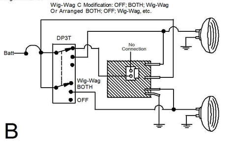

I'm going to incorporate the Perihelion design Wig-Wag (c version) module
Http://www.periheliondesign.com/wigwagmnl.htm
in my landing lights, the call out, wiring diagram 'B' for a single switch is a DP3T, I'm trying to relate this to 'Table 11-1' (S700 series toggle switches) is it a 2-10, if so can you help with the connections
John
PostPosted: Sat Nov 10, 2018 5:39 am    Post subject: Wig-Wag wiring Reply with quote
At 04:45 AM 11/10/2018, you wrote:
--> AeroElectric-List message posted by: "JOHN TIPTON" <jmtipton(at)btopenworld.com>
Hi Guys (Bob)
John
[img]cid:7.1.0.9.0.20181110073102.0583fe90(at)aeroelectric.com.0[/img]
To the best of my knowledge, the device
depicted does not exist in a toggle switch.
A 2-10 can be wired for SINGLE pole, three
position operation which would need a
couple of diodes added to implement the
'both-on' function in the center with the
OFF being full down.
A 2-1 switch can be used with no added
diodes but the operation would be BOTH (down),
OFF (center) and WIGWAG (up).
I can sketch a schematic for either . . .
your choice.

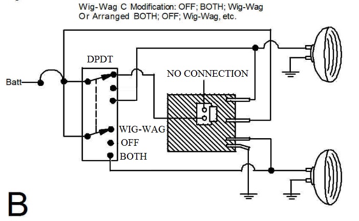

I do not trust switches that depend entirely on rivets to conduct current.
http://www.bandc.aero/toggleswitch-doublepole.aspx
Click on the small pictures on the above website. Notice that the rivets go through plastic. If that plastic flows over time, the electrical connection could fail.
The most economical and perhaps easiest to wire switch is a DPDT with center off. ON-OFF-ON Do NOT buy a switch that has parentheses, for instance (ON)-OFF-ON. Parentheses indicates a momentary position.
Once you have the switch in hand, it is easy to figure out how to connect it by using a test light or ohm meter.
DP3T switches are available from electronic parts suppliers like Mouser and Digikey.
https://www.mouser.com/Electromechanical/Switches/Toggle-Switches/_/N-5g2jZ1yzvvqx?P=1z0z28fZ1z0z2o3&Ns=Pricing|0
DPDT switches:
https://www.mouser.com/Electromechanical/Switches/Toggle-Switches/_/N-5g2jZ1yzvvqx?P=1z0z2xkZ1z0z2qcZ1z0z810Z1z0z80lZ1yy48toZ1yyg5u9Z1z0jl5uZ1z0zlgaZ1z0sf9tZ1z0zlgkZ1yzs6ii&Ns=Pricing%7c0
A center off switch could be mounted so that the on positions are left and right instead of up and down.

Wiring diagram using a DPDT center-off switch.

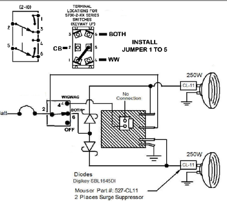

Here 'tis . . .
[img]cid:7.1.0.9.0.20181110122916.05298400(at)aeroelectric.com.0[/img]

At 04:30 PM 11/10/2018, you wrote:
PS: I have a spare Bridge Rectifier, can I use two of the diodes
Yes. You use the common annode (-) terminal
as the power input from the switch. Tie the
AC (~) terminals to each light. Ingnore the
common cathode (+) termial.
PostPosted: Sun Nov 11, 2018 5:52 am    Post subject: Wig-Wag wiring Reply with quote
At 06:10 PM 11/10/2018, you wrote:
How abouit DSTF3060CR Schottky, 2 diodes in one TO-220-2 package, available at Mouser?
That would work, but the el-cheapo bridge would be good too . . .
Save on shipping cost by ordering Schottky diodes and current limiters from same source.
Current limiters not necessary for anything
but the really BIG incandescent lamps . . . and
even then, their benefit is probably hard
to quantify.

I only mentioned current limiters because a highly respected
contributor to this forum had included them in his drawing posted above. Smile
Yeah, my bad. The conditional callout
for current limiters got cropped off
the original art from Eric's website.
Did some dynamic studies of the current draw
by incandescent lamps in wig-wag systems
about a decade back. Seems 55w and larger
lamps don't have time to cool off between
flashes. The only time they present the
typical cold-lamp inrush is on first
light . . . every subsequent flash is
quite benign for 'start up' current.

Hi Bob - Further to your diagram (2-10, Off-Both-Wig-wag) you have a permanently live lead (terminal 2) going to the wig-wag unit, would it not be better (good practice) to put this lead on terminal 1, making that lead 'hot' only when the switch is in one of it's two 'on' states - Regards: John
PostPosted: Sun Nov 18, 2018 5:52 am    Post subject: Wig-Wag wiring Reply with quote
At 05:38 PM 11/17/2018, you wrote:
--> AeroElectric-List message posted by: "John M Tipton" <john(at)tiptonuk.eu>
The artifact you've cited was left
over from Eric's original drawing, but
your suggested modification sure wouldn't hurt . . .
