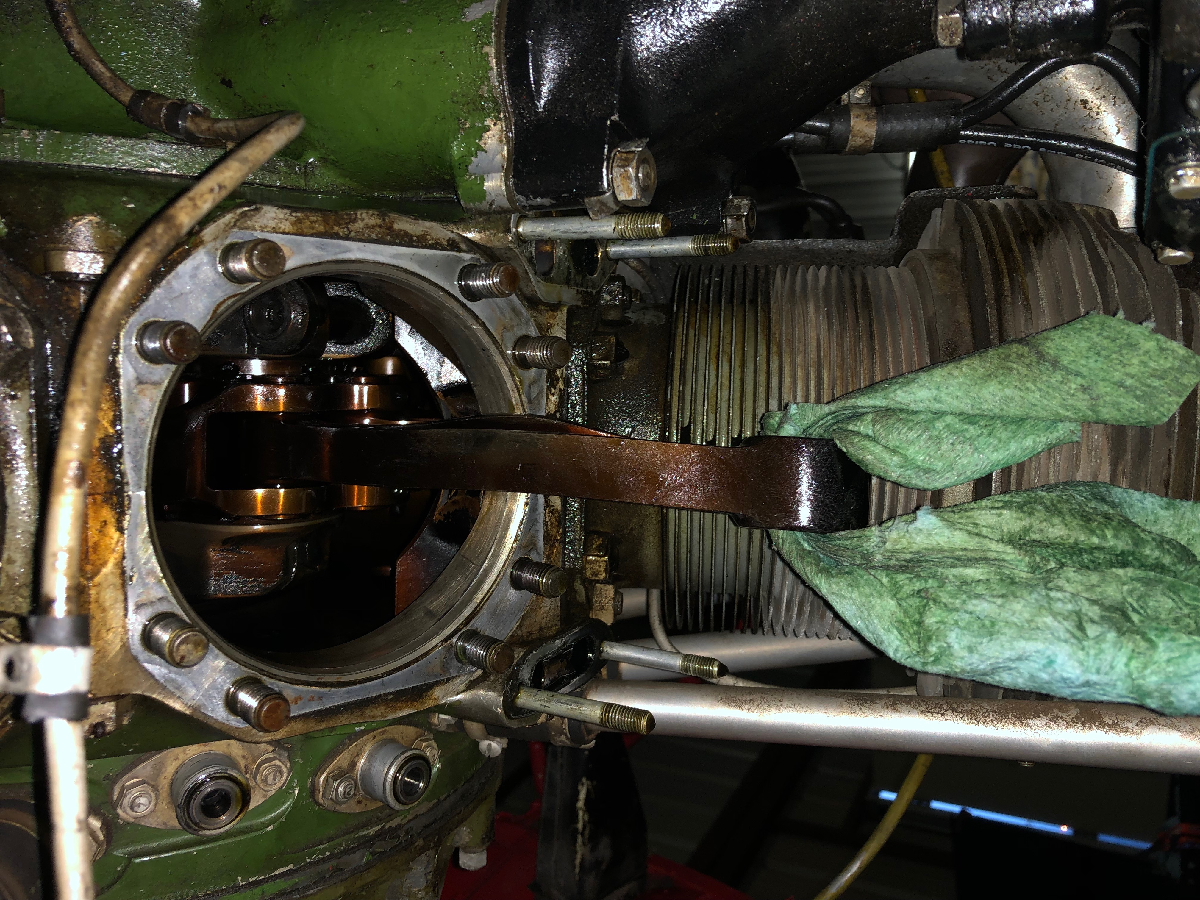

Connecting rod cyl # 5 is bent, can the cylinder be replaced
ssvoysky(at)gmail.com
PostPosted: Tue Nov 20, 2018 1:10 pm    Post subject: Connecting rod cyl # 5 is bent, can the cylinder be replaced Reply with quote
[img]cid:493629543530097560165148[/img]
 Filesize:  2.95 MB
 Viewed:  2049 Time(s)
migfighter42(at)gmail.com
PostPosted: Tue Nov 20, 2018 1:48 pm    Post subject: Connecting rod cyl # 5 is bent, can the cylinder be replaced Reply with quote
Doesn’t look as bad as mine, but you need to check the crankshaft. At that point, it’s pretty far apart so...
