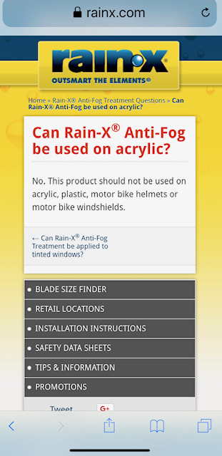

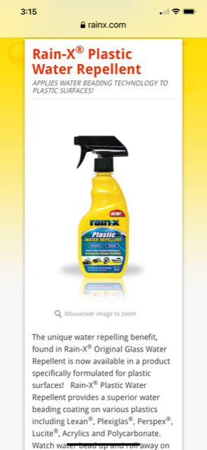

PostPosted: Sun Jan 20, 2019 2:26 pm    Post subject: Pulsar in the rain Reply with quote
https://www.rainx.com/faq/can-rainx-antifog-used-acrylic/
[img]cid:B06EDA38-C21F-46F7-BC60-B06387F95B1E[/img]
https://www.rainx.com/product/plastic-water-repellent/rain-x-plastic-water-repellent/
[img]cid:C836056B-4EAC-4483-9C16-51C6E0D387F7[/img]
