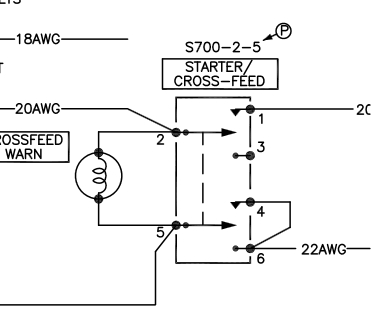

Second issue. The starter cross feed switch on Z-14:
In Appendix Z-14, the switch is labeled S700-2-7, with a Circle L, yet the drawing shows momentary-on the start side but stays on in the cross feed position. 2-7 is an (ON)-OFF-(ON) switch, not the (ON)-OFF-ON shown which seems to be an S700-2-5. Does the circuit self-energize and so does not need the switch to stay the Crossfeed position? If yes, does it disconnect when we turn off both masters?
Then on page 17-10, Bob proposes the S700-2-50 for the combined starter and cross feed.

2-50 and 2-7 are errors. The latest drawing on
the website shows that the error was corrected
when 2-5 was called out at revision P
[img]cid:7.1.0.9.0.20181223203444.002beff8(at)aeroelectric.com.0[/img] [/b]
