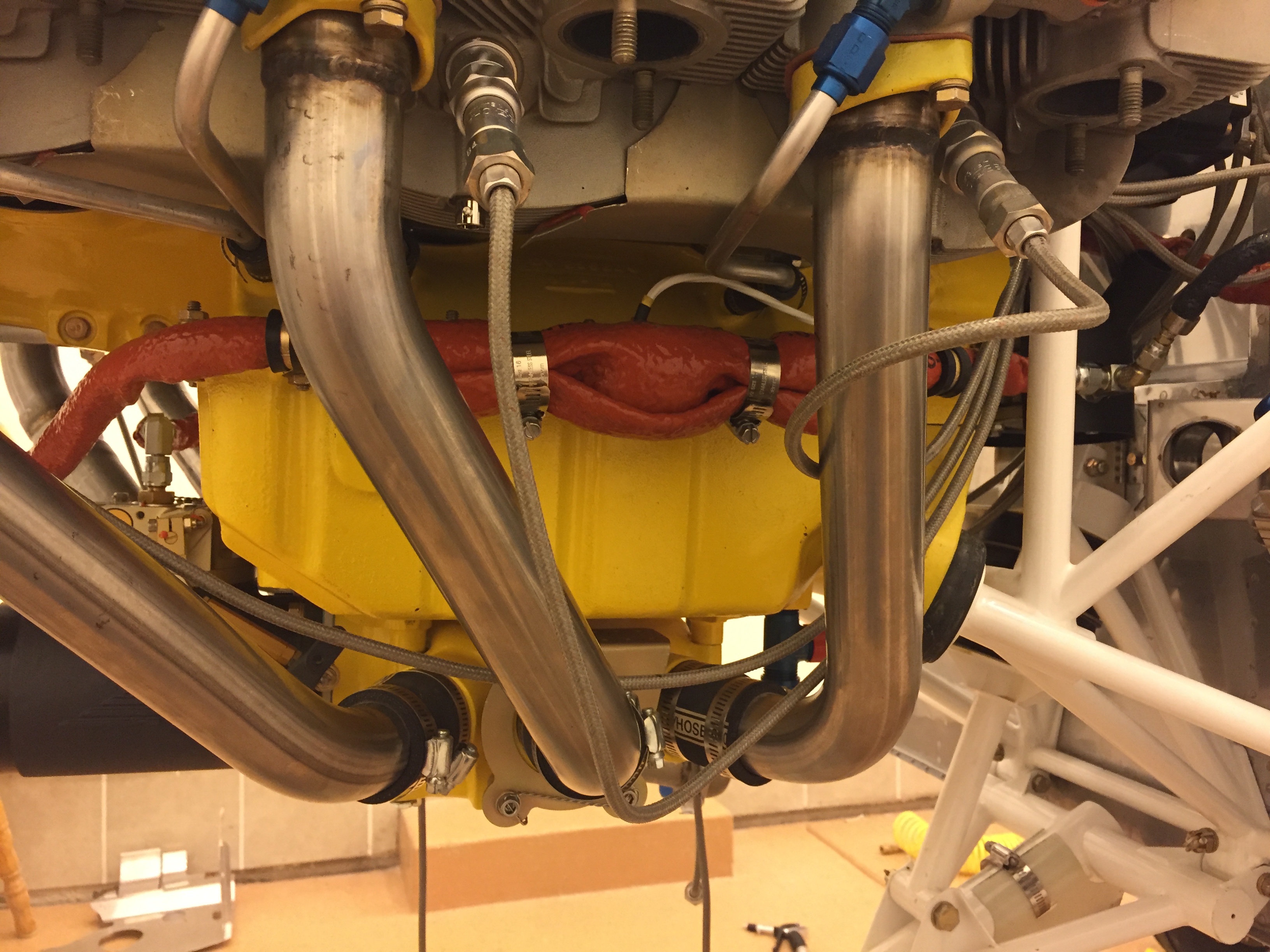

 Filesize:  1.76 MB
 Viewed:  23659 Time(s)
Robert J Jones
702-521-1840
TimRVator(at)comcast.net

I suspended my FP-5 in the line between the fuel servo and flow divider
IAW the drawing on page 20 of the FT-5 manual.  I wrapped the transducer
with fire sleeve per the instructions.  It has worked well in this
location for 4 years and over four hundred hours. Several other RV's
have done the same thing.  I believe Airflow Performance recommended
this location to me.
This location eliminated the surging fuel flow readings I used to see.
