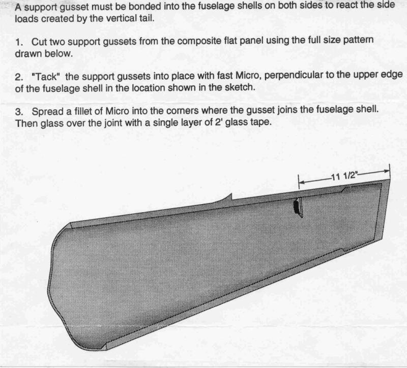

PostPosted: Wed Jan 23, 2019 12:33 pm    Post subject: New Member Pulsar Builder Reply with quote
Example of a picture on the old yahoo site this of a support gusset for countering the starter torque caused cracking
[img]cid:4D391576-4115-4BD9-BA20-4D9A840756F2[/img]
