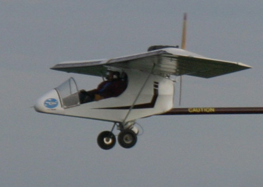

Richard: I had an Original FS with an aluminum/polycarbonate gap seal that went a little over a foot back on the bottom side. I am 6' 2+" with a fairly long torso. A friend had a similar situation (not as tall but a longer torso) in his Original FS. I think Dennis Souder came up with a solution (which I copied). Cut a hole in the underside of the gap seal big enough to receive an inverted 10" aluminum pie pan. That was deep enough to give you an additional 1" plus head room. The angled sides of the pie pan didn't offer any significant restriction for head movement.
The best picture I could find is attached. Not very clear but you can see that the top of my helmet is above the bottom surface of the wing.
Good luck!

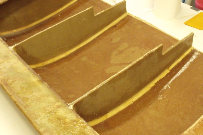

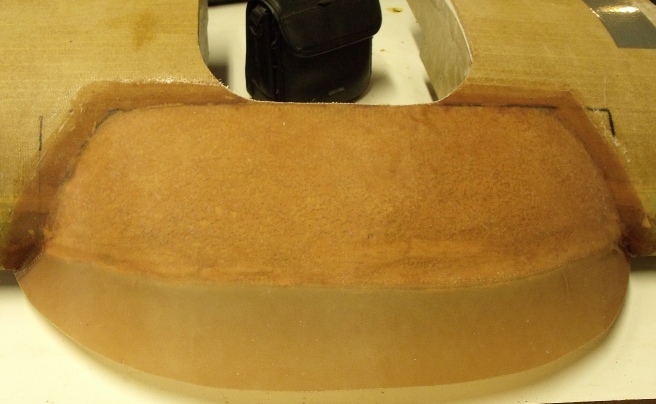

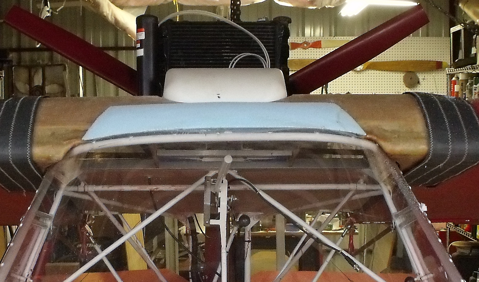

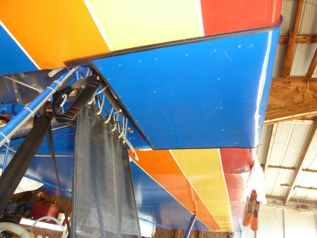

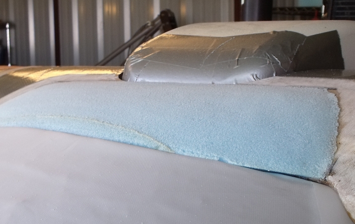

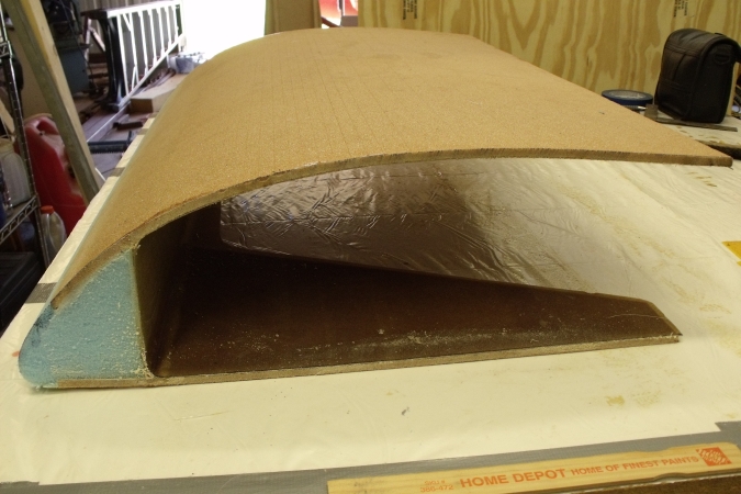

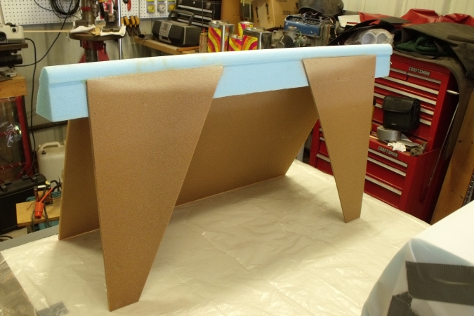

I've attached several pictures of the gap seal/windshield fairing that I built of composites for a MK IIIX. Gives you the general idea of what and how I fit and built it. If you need more I can provide pictures to try and answer questions.
Rick

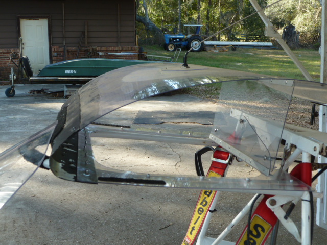

Thanks to all who sent replies. I attached a pic of my gap seal. Do any of you with a rigid gap seal have it set up so it stays in place & you just fold the wings into it? As you can see from my picture, the wind shield rests on top of the center section hoop and continues up about 1 1/2". With the center section mounted, the wing leading edge tubes hit the front of the gap seal & prevents the wing from mating with its anchoring pin. If the wing is first folded all the way forward & pinned, then the wind shield sticking above he center section hoop blocks the gap seal from being inserted. In order for this to have worked, I am thinking the wind shield must have been put on after the gap seal was installed. Maybe I am missing something here?
I might be able to use this gap seal if I cut the top of the wind shield flush with the top of the hoop, but since the wind shield is not physically attached to the hoop (only to the nose cone) it might not be secure enough to handle any wind side loads as when crabbing.
I am looking for a quick fix so I can get this into the air. I will do full or semi-full enclosure down the road. Any ideas out there? -Richard Swiderski

Richard, I don't think you can get there from here. It's just the geometry of the way the wing swings. What you might consider is having the wings butt up against the gap seal rather than having them slide into it. Use some sailplane gap seal tape when the plane is all rigged. That's the solution I used on the Mk IIIX.

Cut off the top part of the windshield that projects higher than the hoop.
Make up a piece of aluminum that can replace the top of the windshield that you just cut off. Shape it to seal the area above the windshield to the gap seal. Maybe put some velcro on it where it touches the gap seal, if necessary.
Get some blind nuts like these or similar and put about three of them on the inside of the hoop. https://www.aircraftspruce.com/catalog/hapages/anchornutsmk1000.php?clickkey=3026140
Install the wings, install the gap seal, install the new windshield top piece that you just made, and then put in some screws to hold the windshield and windshield top piece securely to the hoop. You have added one small step to the assembly process, but you made a lot of other things simpler because now you can put the gap seal on after the wings are on.
