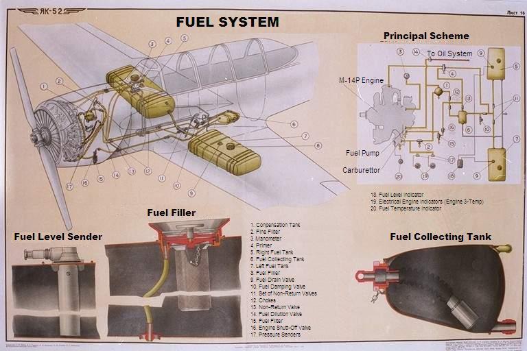

FYI - there are no hoses from the main tanks to the header tank on the Yak 52. Beneath the front seat is a fuel junction which sits horizontally in the aircraft. This is also where the flapper valves are located. The main tank fuel lines go to this fuel junction. On the back side of the fuel junction, facing aft, is a metal line connection that goes to the fuel sump drain under the belly of the aircraft. On the other side of the fuel sump drain is a metal line that goes up to the header tank, which is located under the floor on the left side of the rear cockpit. I'm attaching an original Russian Training Class slide for the fuel system, with English translation.
[img]blob:https://mail.yahoo.com/b52dfafd-53fe-42a0-b631-433a52dd1700[/img]
Doc's suggestion is the perfect solution. I prefer to tell them it's a Polish tractor instead of Russian though. Smile)

PostPosted: Mon Feb 18, 2019 7:13 am    Post subject: Hoses Reply with quote
Oops.  Here's the attachment.
Dennis
A. Dennis Savarese
334-546-8182 (mobile)
www.yak-52.com
Skype - Yakguy1
Dennis
