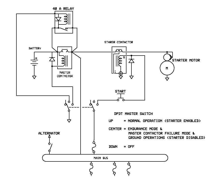

Each builder has their own ideas on how to wire their airplane. It would be nice to offer more “Z” figures to give builders more electrical diagrams to choose from.. Modern EFISs have a built-in low voltage warning. So the new “Z” figure will not need low voltage warning. Many EFISs come with their own internal backup battery that will last for an hour or more. Some builders might not want or need an E-Bus. Below is a circuit without a separate E-Bus. But it does have a relay in parallel with the battery contactor. That relay provides a parallel current path similar to an E-Bus relay.
For normal operations, the master switch will be in up position. If the pilot wishes to conserve electrical energy for any reason or if the battery contactor fails, the pilot can move the master switch to the center position (endurance mode). The power hungry battery contactor will be disabled and the relay will turn on. Symptoms of battery contactor failure may be abnormal fluctuations of system voltage.
The center position of the master switch is also useful for ground operations such as electrical troubleshooting or just sitting in the aircraft learning how to use the avionics. The relay uses a fraction of the power that a contactor does. The starter is disabled with the master switch in the center position, making it safer while working on the plane.
