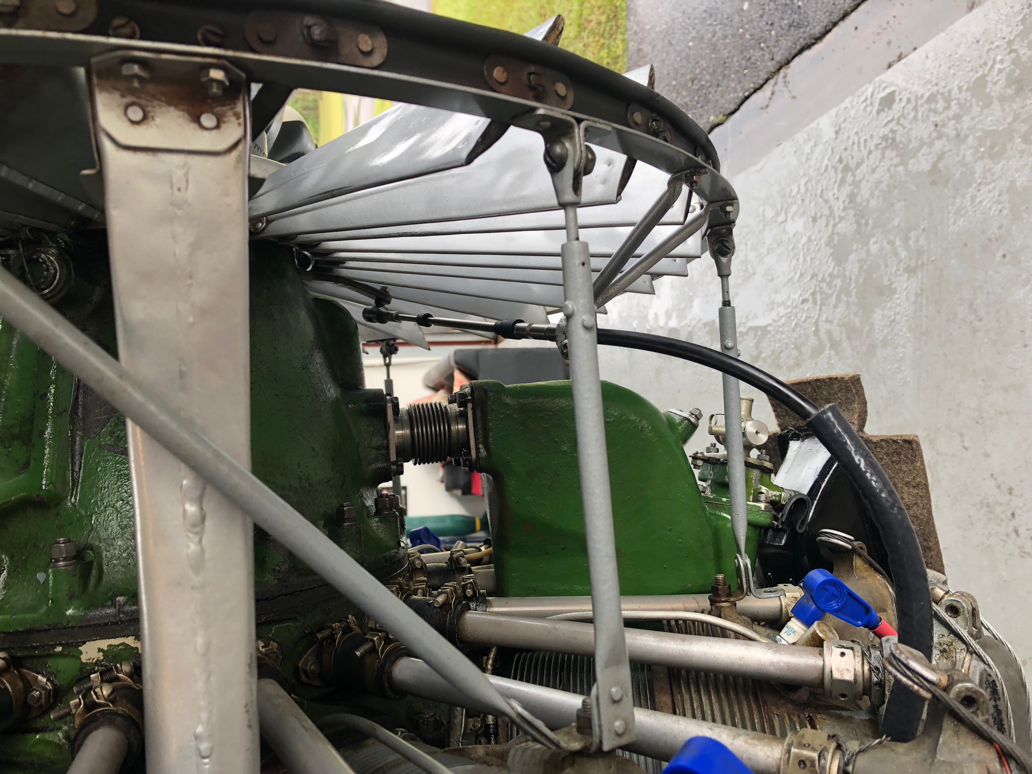

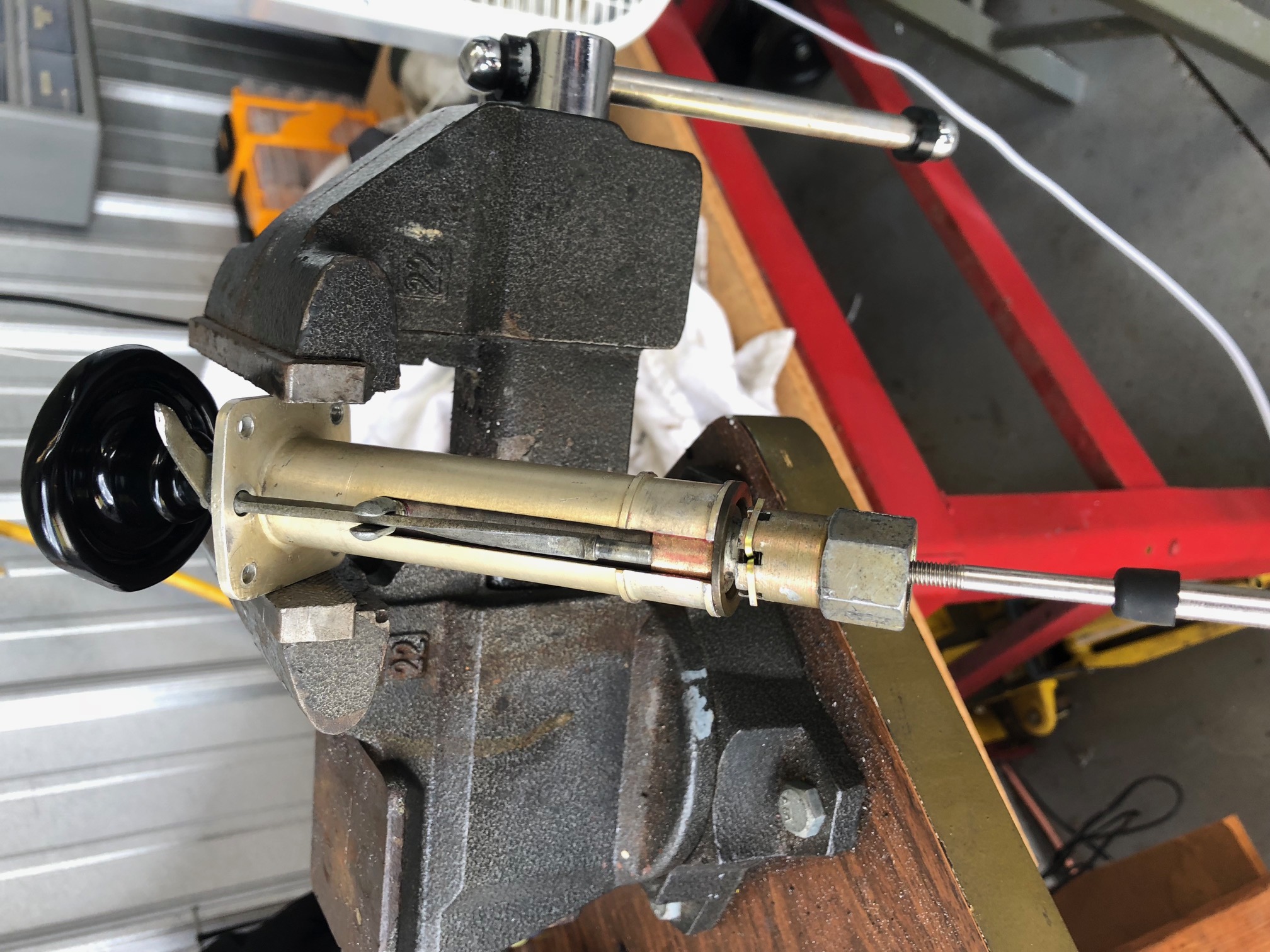

hkgibby(at)yahoo.com
PostPosted: Thu Mar 28, 2019 6:21 am    Post subject: Shutters cable Reply with quote
Pedro-
Yes you can;  I have for both the shutter and prop Gov control. Email me directly for more pics and details if you decide to do it. The Universal ends can take the metric chinee/Rusky metric connector as it is 10/32 which is close enough for metric M4 or M5, can’t remember. Trickiest part for the shutters is the cockpit connection and whether you keep the Chinese/Russian control knob/lever mechanism.
https://www.greatlakesskipper.com/teleflex-tfxtreme-3300-33c-boat-control-cable-ccx63322-22-foot-134809?utm_source=google&utm_medium=cpc&adpos=1o4&scid=scplp8201349&sc_intid=8201349&gclid=EAIaIQobChMIq9_B0_yk4QIVwh-tBh2fCwHyEAUYBCABEgKpGvD_BwE
[img]cid:4E900DF5-DBDD-4E83-BDFE-7AEFF117427E[/img]
[img]cid:726F9A3C-51E9-46B5-AA29-54CA21DC223F[/img]
On Mar 28, 2019, at 4:44 AM, Pedro Cerveira Pinto <cerveirapinto(at)gmail.com (cerveirapinto(at)gmail.com)> wrote:
Hi there
Does anyone know if the cable that opens and close the shutters of the engine can be replaced by a marine teleflex cable?

Bugger is right. I had to use a grinder to thin the copper tubing to paper thin. I then used a chisel that I ground the tip down to sharp edge. The lightly skived the chisel along the thin wall splitting the cable. Usely the cable is gummed up along its shaft in the curve of the cable housing from oil and dirt. Doc

Correction: the chisel was skived parallel along the cable to split the copper housing.Doc
