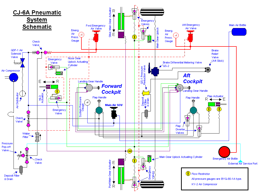

PostPosted: Thu Mar 28, 2019 12:19 pm    Post subject: How do I bypass the rear flap handle? Reply with quote
Have you seen this diagram.  It is on Doug's website and layout the air system very nicely.

PostPosted: Thu Mar 28, 2019 12:39 pm    Post subject: How do I bypass the rear flap handle? Reply with quote
It may not be the flap handle. It also could be the flap actuator too, leaking by the seals. If you put the rear flap handle in neutral and the front flap handle in the UP position, do you hear air leaking from the front flap handle?

dsavarese0812(at)bellsout
PostPosted: Thu Mar 28, 2019 3:46 pm    Post subject: How do I bypass the rear flap handle? Reply with quote
There are also two diverter valves at the rear gear selector that you must consider as well when bypassing the rear selector. Notice them on the schematic that Mark Pennington sent you.
