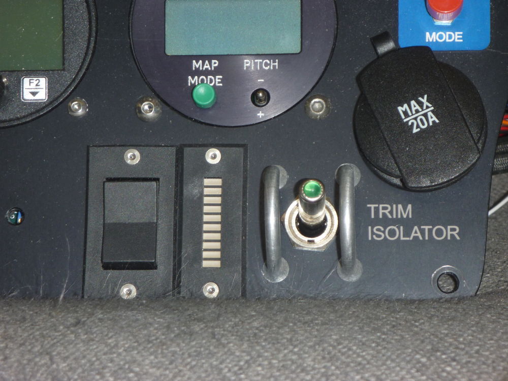

rowlandcarson(at)gmail.co
PostPosted: Wed Apr 10, 2019 5:07 am    Post subject: Anyone experienced trim runaway? Reply with quote
On 2019-04-10, at 13:19, Richard Lamprey <lamprey.richard(at)gmail.com (lamprey.richard(at)gmail.com)> wrote:
Trim runaway seems to be rather alarming. It seems that a quick CB cut off is needed close to hand
Richard - I agree! Here’s the bottom corner of my “radio” panel showing the guarded isolator switch close to the trim switch & display.
in friendship
Rowland
| Rowland Carson ... that's Rowland with a 'w' ...| <rowlandcarson(at)gmail.com (rowlandcarson(at)gmail.com)> http://www.rowlandcarson.org.uk| Skype, Twitter: rowland_carson Facebook: Rowland Carson
