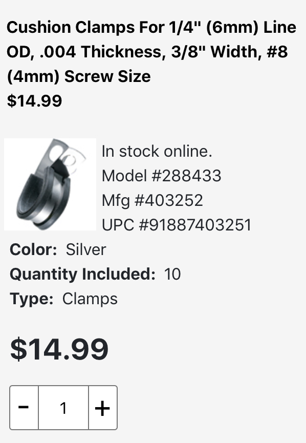

For lo these many years I’ve looked for the right P clamps for the CJ, 6mm diameter with a 4mm bolt hole.
All the US stuff has a 6.4mm (1/4”) bolt hole which is larger than the head of the 4mm screws that hold many of the OEM clamps in place.
Then today David Dufreche solved my problem:
https://www.westmarine.com/buy/ancor--stainless-steel-cushion-clamps-10-packs--P009_275_003_012
Model 288433 appears to be just what the doctor ordered.
[img]cid:9E7BE18F-E3B2-4B83-9D12-E9DF7B474898[/img]
So there y’all have it. Enjoy.

Excellent news, thanks for passing on!!!!Justin / N280NC
