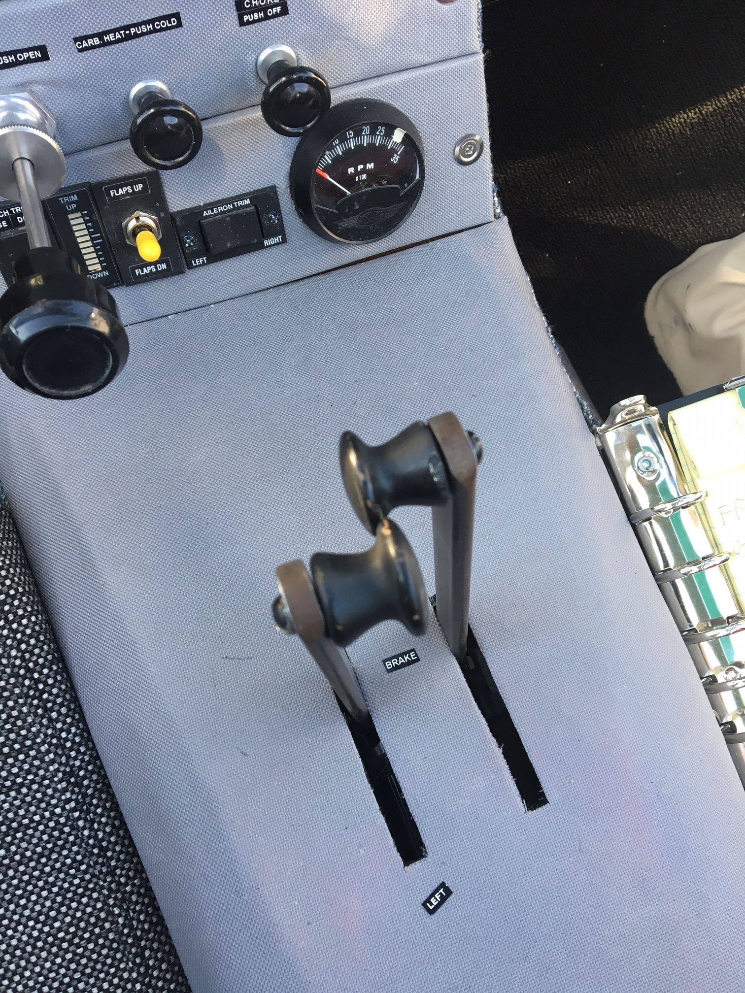

I am flying my Europa XS with the Jabiru 3300A. I kept it simple and used a vernier throttle control from ACS. I placed it on the forward part of the center console. I placed the carb heat and choke controls next to it. Works great for me.
https://www.aircraftspruce.com/catalog/appages/a750.php?clickkey=131607
Ignore the dual finger brakes. This pix was a record showing to NOT use these type knobs because they can get stuck like this and cause an issue. I simply went to straight knobs.
Hope this helps.

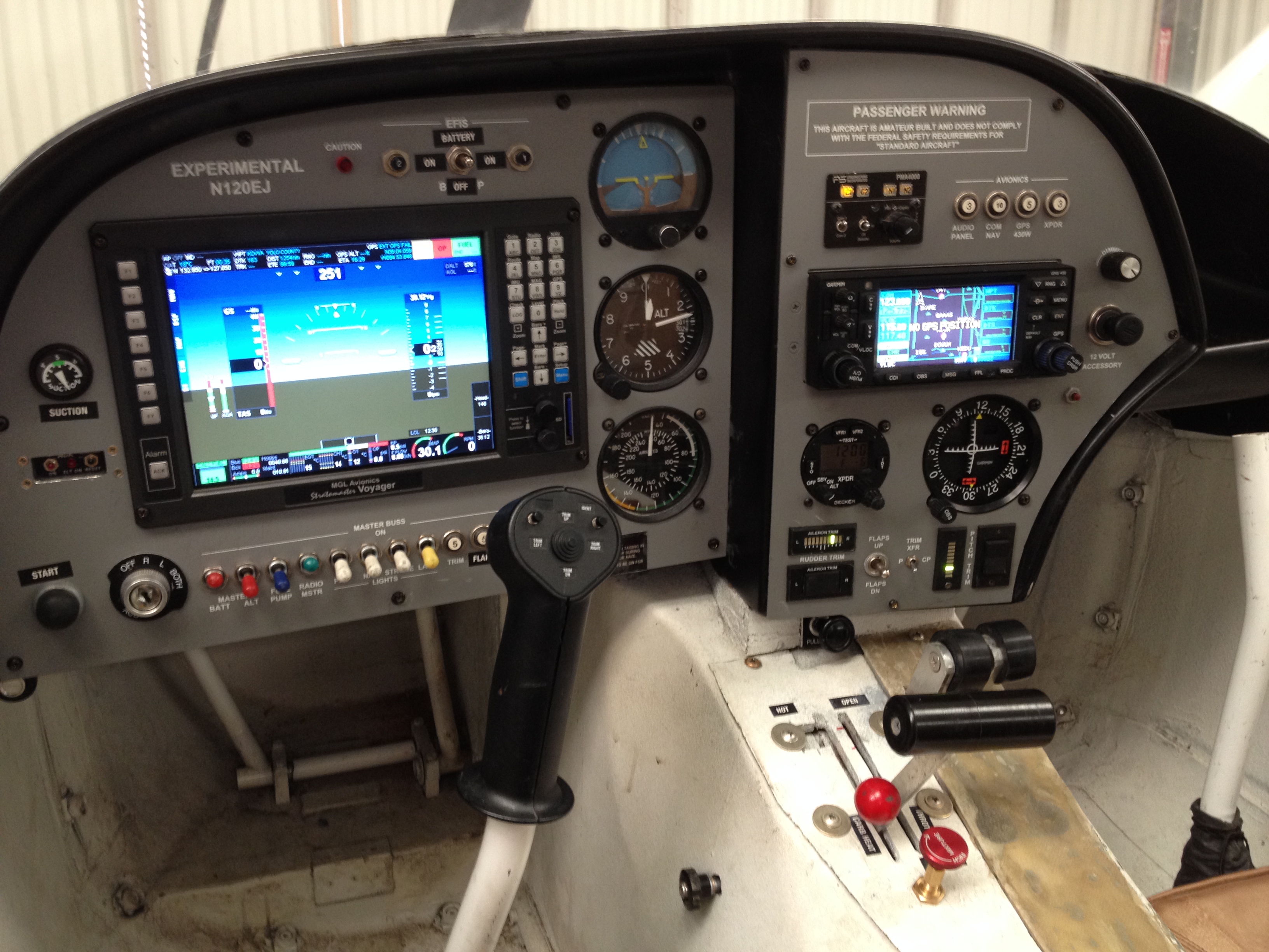

Almost any control will work. Take a look at the McFarlane Aviation Catalog. https://www.mcfarlaneaviation.com
The Bing Carb is sprung loaded to full throttle. So the cable needs to pull the throttle plate towards the rear. I used a Tee bar type of throttle with Carb heat. I like the feel, but would not recommend it as it was difficult to move out of the way for brake bleeding. My picture is to large for this program, I can sent it off-line.
Rick Stockton

Hi Rick,
I see your images. Thank you for those and I will have a look at the McFarlane vernier throttles. I appreciate your help.
