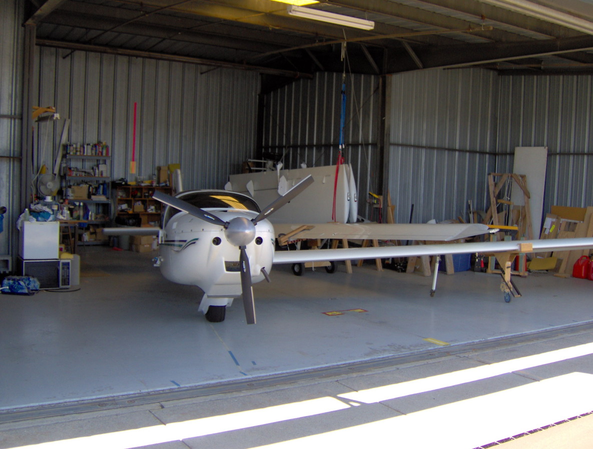

Hopefully Bud Yerly will answer all your questions but here's what we know. We've have a set that we've started, but likely will not complete.
The glider wings are at least 100 lbs heavier. This severely restricts their usefulness for touring.
You are right, there are few photos of a mono with glider wings. I've attached a photo of Terry Severs with one wing in place. Dave Anderson and Ken Carpenter are two mono gliders but no photos (Carpenters is on Yerlys website but with short wings).
A problem with glider wings on a mono is that the spar mod increases the height of the spar causing it to interfere with the flap actuation rod. We have successfully fitted a push pull cable to solve that problem. Another solution is to go to electric flaps like a trigear.

Here in Canada we can declare whatever gross weight we want (wisely or not). Seeing that the added weight is itself in the wing and results in no increased stresses, I figure I could simply increase the gross with long wings by the same 100lbs without penalty (assuming enough HP). No?
Curious, how much floor-spar clearance is there with the glider spars vs short wings? Is there a possibility that a modified/redesigned drive tube could still work for both?

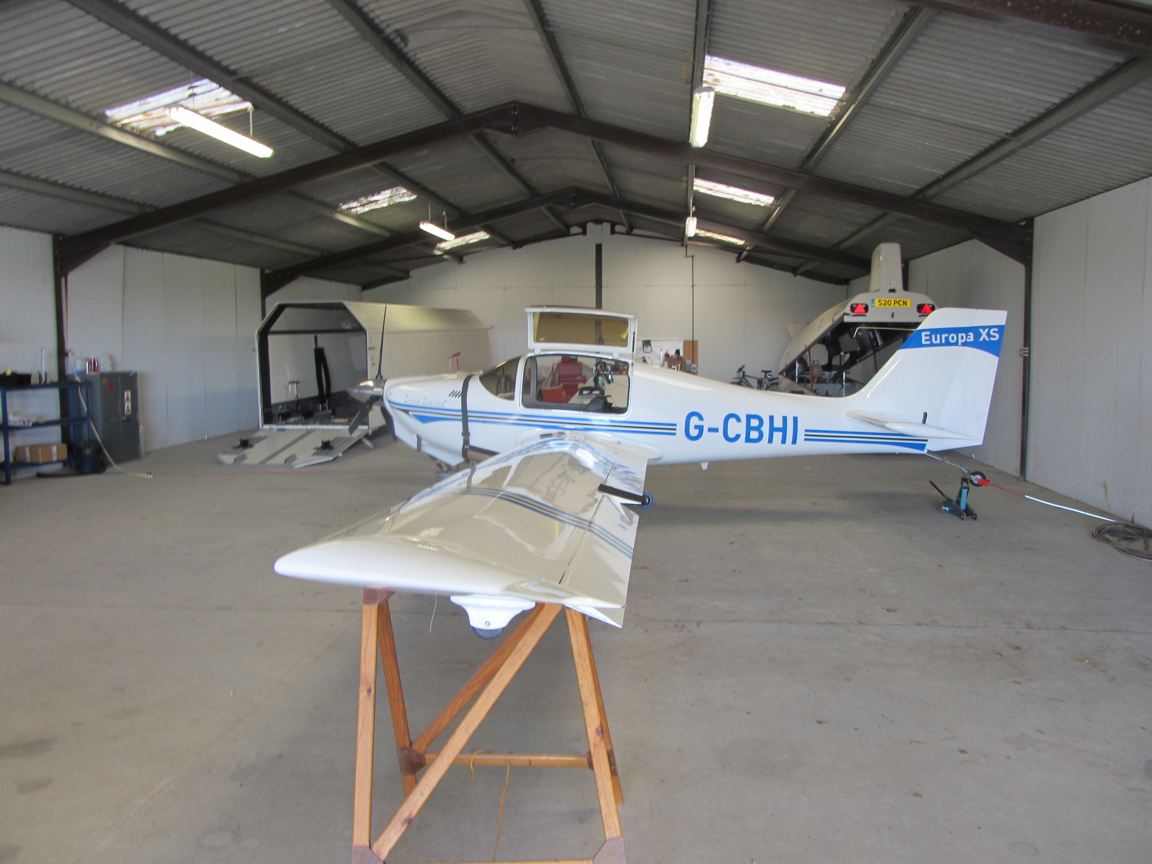

Clive,
I operate the only Extended Wing Europa with a LAA Permit in the UK, G-CBHI. I can change back and forth between XS and Extended Wings with no problem, and use an enclosed trailer built specially in Germany for the mono extended wings. It is shown in the corner of the hangar while I was rigging the machine last winter. It did take a long time to get the Permit, starting in 2009 completed in 2018. The main reasons for the delay were the spar failing when it was plugged into the fuselage for a max structural test at 50 degrees C, hence mod 78. Standing the fuselage next to the hot autoclave full of fuel causing the tank to swell needing a tank change. Both items needed LAA approved repair schemes before the work was completed taking almost 3 years. The LAA then insisted on full spinning trials, over 80 in all. The machine was landed wheels up during this flight trails work taking a further 2 years to complete. After this they wanted a warning system for U/C /airbrakes, a stall warning system. Also there were issues on how to clear it. As a motor glider, touring motor glider or SEP? It did not correctly fit into any of the categories or design requirements. Also written confirmation of the structural clearances for airbrakes flying controls etc was required. A correctly approved Pilots Operating Handbook and audit trail for all the clearance was required from Swift Aviation who had taken over engineering and design approval. It was found the existing XS stall warning did not work correctly on the different wing profile of the extended wing, as the machine could now fly very slowly 45 to 50 knot, having a stall warning going off all the time was just not acceptable. All this added further years, and to cap it all, it got damaged in stormy weather last year when a canopy cover tie broke and managed to undo the canopy handle and remove the door. A further repair scheme was required for this, as all the previous door losses had occurred in flight and were total losses. I have to thank Swift Aviation for their support last year when they were moving their home base from Yorkshire to Coltishall and had so much on. We still do not have the increase in all up mass yet and have a limited C of G, but I am still optimistic that these will come, but further flight trials will be required. However, just in case that drags on I am doing a weight reduction exercise at the moment getting rid of lead acid batteries, vacuum system and gyro instrument etc giving me an extra 20 kg off the basic hull weight.

Hi Clive & Europa Fans! I have a Tri-gear Motorglider LX-CWT, which I have been flying about 300+ hours since 2011. I bought it in 2009 as a mono-wheel, made a couple of flights, before rebuilding to tri-gear. There was an article in the Europa Flyer in the last edition before last Xmas about my experience with the motorglider.
I have a hangar space for LX-CWT, and as the plane did not fit anymore, I sold the trailer to Ian Cook. The trailer was made by Anschau in Germany, who probably still have the drawings if you need one made.
My experiences with the motorglider are largely positive. It will never be a high performance sailplane, but offers fun and above all, it is a very economical touring plane. Not as fast as the short wing, but with 110-115 knots cruise and 13 to 15 liters per hour, who cares? John
