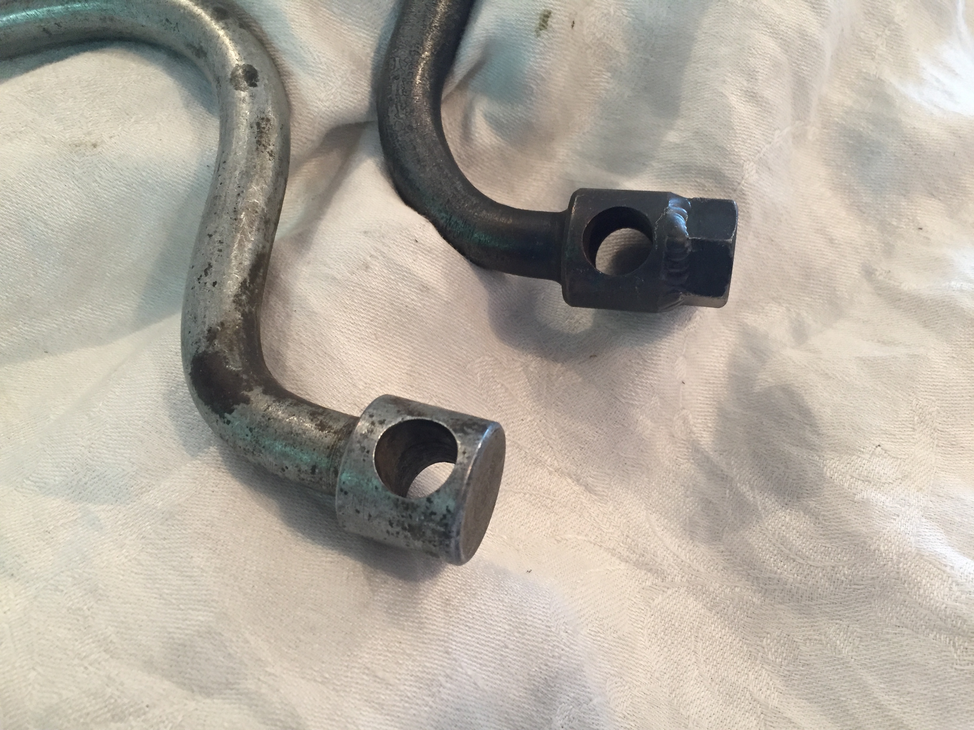

Notes on torque: The factory wrench for this job, Chinese or Russian, provides absolutely no means to measure the torque value.  I weld a nut in the appropriate location. See attached pic.
I use a LUBRICATED 300 to 320 in./lb. torque.
