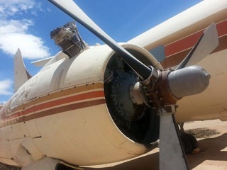

PostPosted: Wed Jun 19, 2019 5:47 pm    Post subject: Hyd. Lock Reply with quote
Don’t forget to turn the prop once or twice.

PostPosted: Sat Jun 22, 2019 10:45 am    Post subject: Hyd. Lock Reply with quote
Once or twice? Min 14 full revolutions has always worked for me
