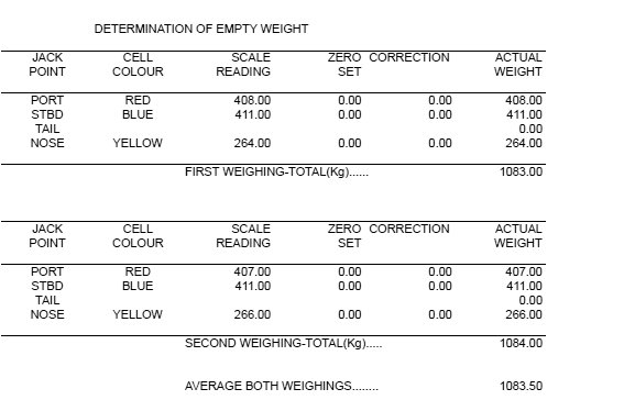

PostPosted: Wed Jul 03, 2019 11:15 pm    Post subject: Re: Another weight and balance question Reply with quote
Here are my weights after replacing Housai with M14PF all in Kgs

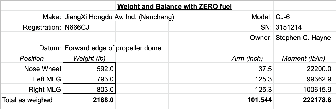

PostPosted: Sat Jul 13, 2019 5:19 am    Post subject: Re: Another weight and balance question Reply with quote
Here mine - just before certification last year and all old radios removed (lightest possible!). I have a google Spreadsheet here...
https://docs.google.com/spreadsheets/d/1jcIDqVtKRMBy5qm_kkyiOnqxakVXHI5eCX-4oaczPL8/edit?usp=sharing
