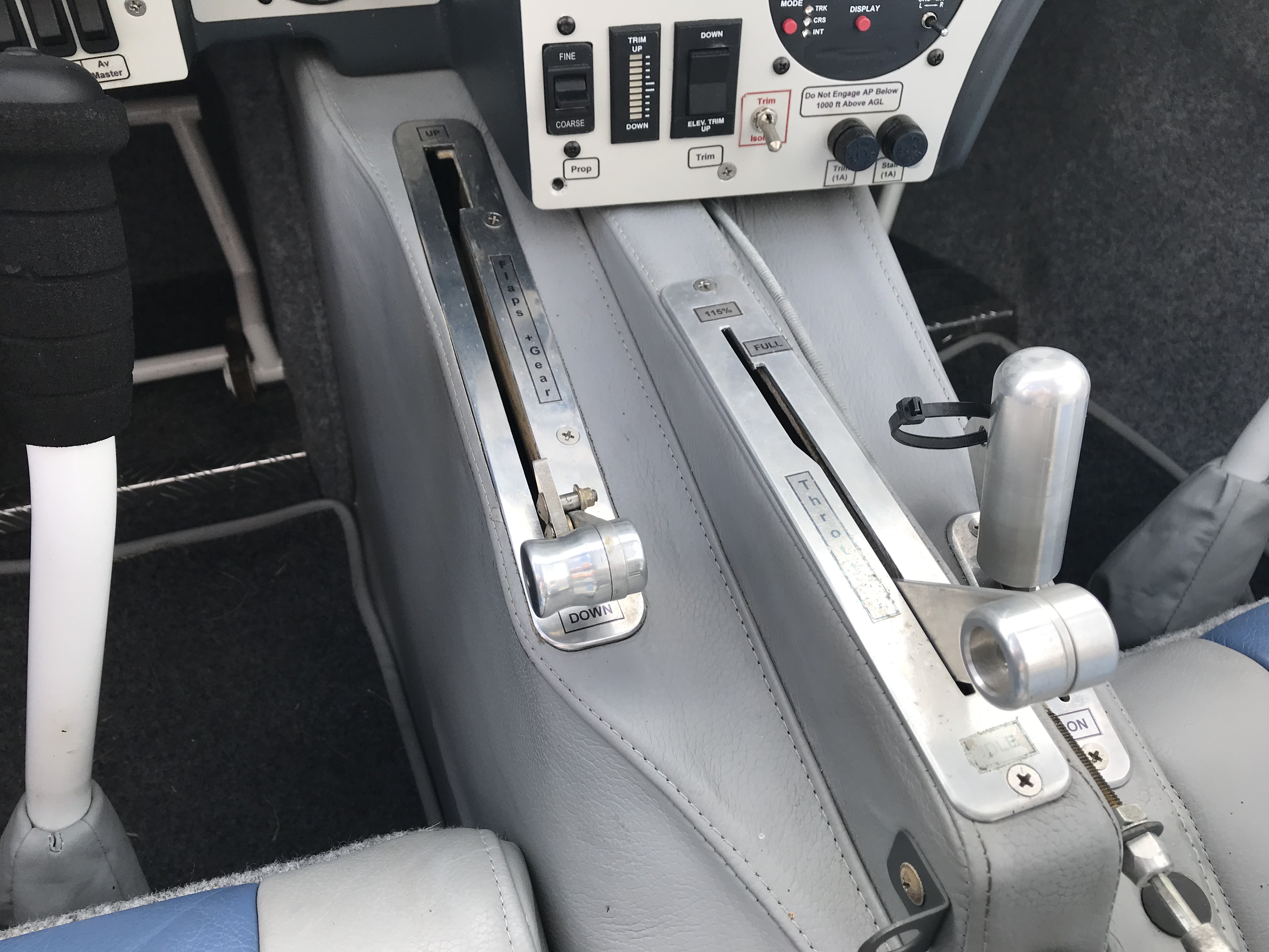

PostPosted: Fri Jul 12, 2019 2:31 am    Post subject: Re: 914 100% Throttle Gate Reply with quote
I think this type is the norm for most Europas...
Throttle facia plate with gate for turbo operation.

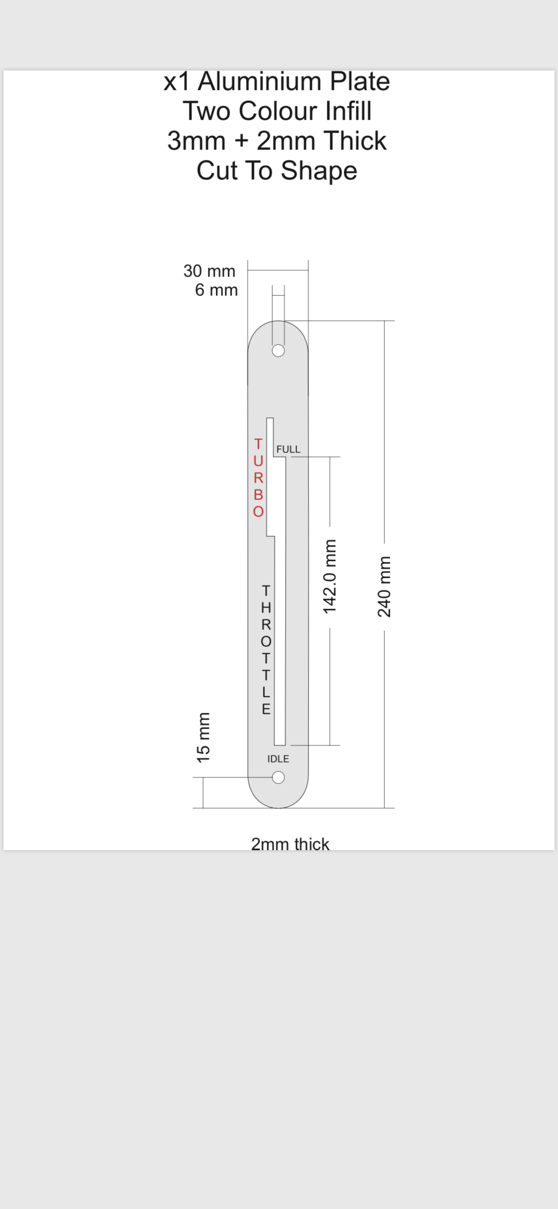

PostPosted: Fri Jul 12, 2019 5:08 am    Post subject: Re: 914 100% Throttle Gate Reply with quote
Hi Ron. I think this is what your looking for
