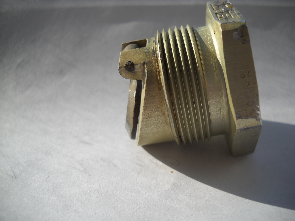

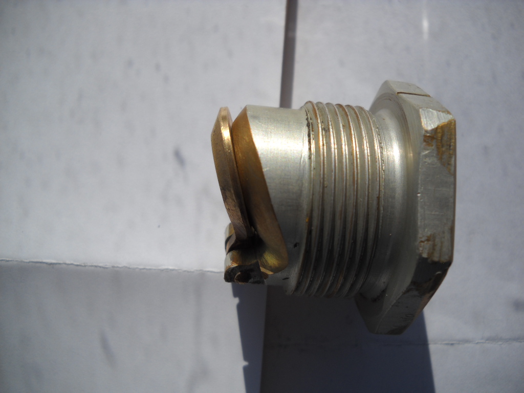

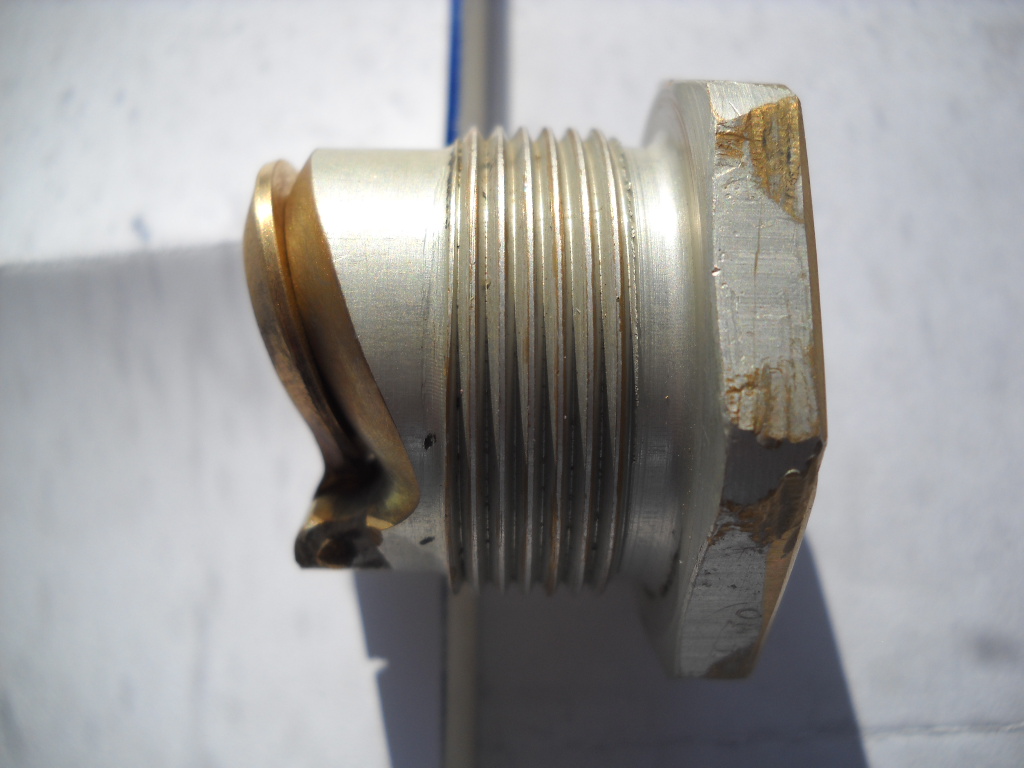

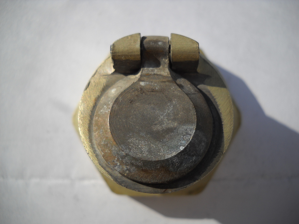

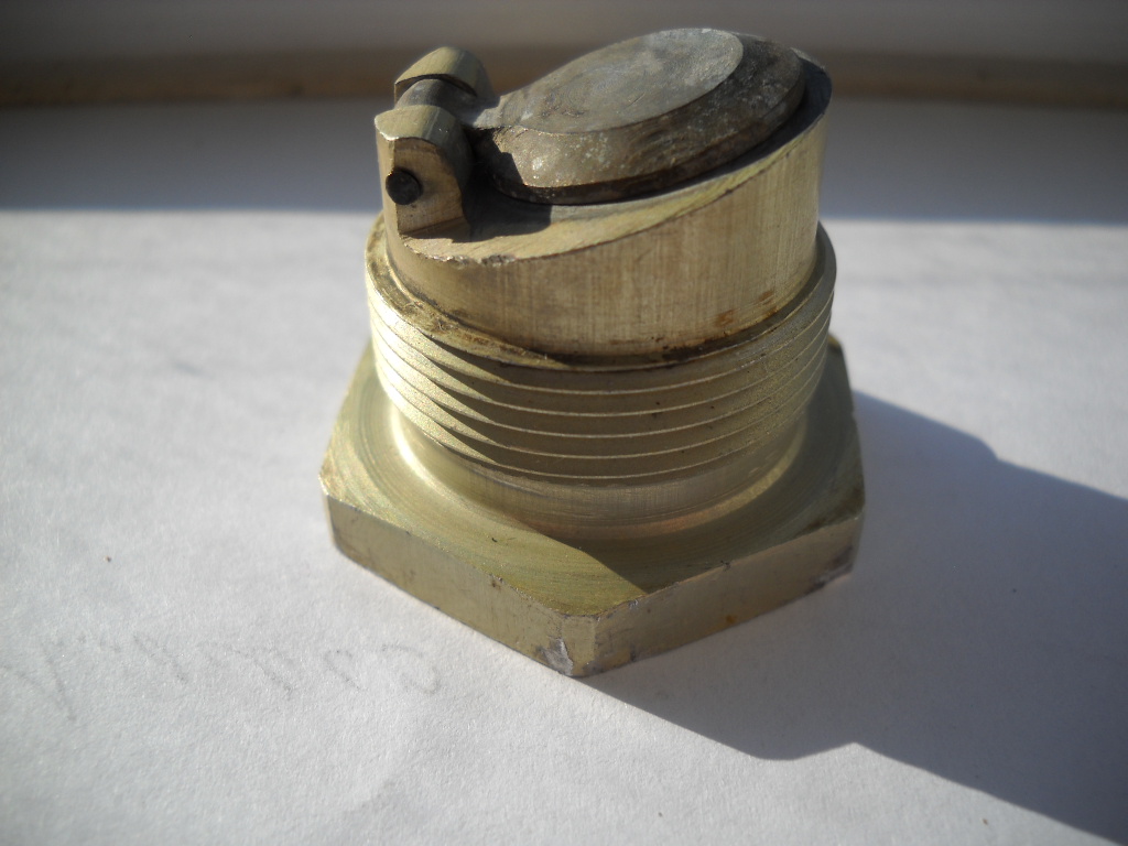

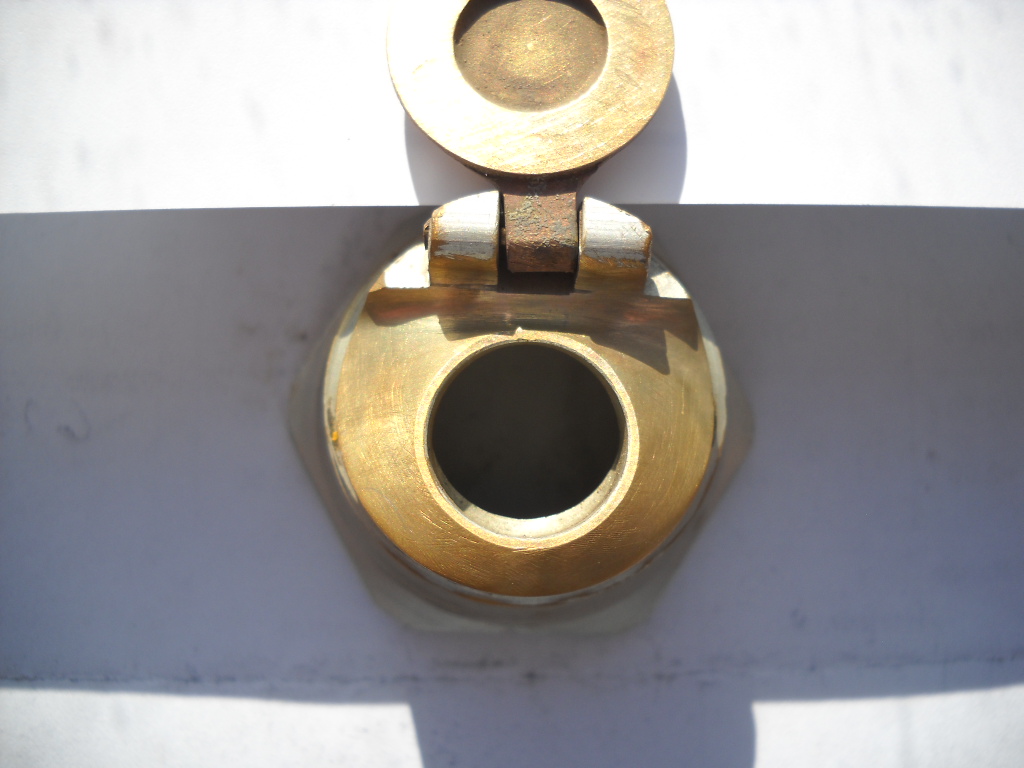

PostPosted: Sun Jul 07, 2019 7:43 pm    Post subject: CJ6 fuel management: What happens when... Reply with quote
Hi Mark,
Since you have had the flapper valves out you are familiar with the major challenge presented with their re-installation. The probability of finding a new crush washer of exactly the correct thickness to ensure adequate torque to avoid fuel leakage and at the same moment position the flapper valve hinge exactly at the top where it must be for correct operation.
There is no info given on this in any of the CJ manuals I have seen but aircraft fuel and /or fuel vent systems commonly utilize these valves. They are designed to operate only with the hinge at the top.  Deviation beyond +/- 5 deg. is not acceptable. The valves are clearly marked with the required position but of course on the CJ that marking is in Chinese!
There are in fact three of these valves in the CJ. The one location where the valve is used exactly as it was designed for is the fuel line from the header tank to the eng. driven fuel pump. In this location it prevents wobble pump fuel from being pumped back to the header tank and re-sucked by the pump. It works perfectly here due to the positive differential in pressures on either side.
In the header tank it sort of half-ass works but the valve was not designed for this particular purpose. If you take a good look at this you will see that the closing pressure works on a valve surface approx. twice the area of the opposing opening pressure. In theory this means that in a probably mythical flight with zero turbulence one tank would have to be empty before the other tank could even begin to feed.
Add that to contaminated and or damaged vent system and you have a recipe for problems.
I have modified my valves to reduce this differential so that the valves work correctly for this particular function.
I rarely ever see fuel differentials in excess of 3-4 litres except after slow (or point) rolls where there is some negative “G”.  In this case the header tank and valves are totally confused and fuel is just running back and forth. Might have 10–15 litre differential which returns to normal in about 5 mins. of level flight.
See attached. First 3 pics are original, next 3 after modification. I have done a few for others but probably not worth the effort unless the vent system is in good order.
Walt
