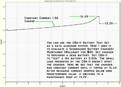

A few weeks ago I purchased a Battery Minder
Plus charger/maintainer. A Lister supplied
me with a near end of life SVLA battery
as a test article to evaluate this new
product from Battery Minder. This
product claims to have added desulfation
technology for even better performance
as a battery maintenance device.
I've looked at the charging output on a
'scope and yes . . . there are some spikey
pulses coming out that must be artifacts
of the Battery Minder approach to 'desulfating'
the battery. I'll have more to offer on this
product later . . . it takes WEEKS to evaluate
the efficacy of this process. Suffice
it to say that I'm not impressed nor did
I expect to be.

A battery charger-MAINTAINER will top
of the battery one time and then revert
to a maintenance mode that is only
capable of offsetting self-discharge
currents . . . and can only enhance
battery service life.
[img]cid:.0[/img]
As for desulfation . . . ask to see
laboratory test results that prove efficacy
of the product's performance claims.
But if you fly regularly, even the well
crafted maintainer will be of no demonstrable
benefit.

But given the cost of suitable
instrumentation is so low . . .
[img]cid:.0[/img]
. . . there's not much standing in the way
of checking things out. One can easily
measure the parasitic leakage of their
favorite maintainer.
Then there are practical design goals.
That 1 mA of current I measured suggests
a voltage sense impedance on the order
of 12,000 ohms. As a general rule,
one doesn't want components in their design
to dissipate any more energy than necessary
to meed operational design goals. 1 mA
is not out of line . . . modern electronics
could probably build a maintainer with
100 MICRO amps of parasitic powered-down
draw. I would be surprised to find one
that sucked 10mA in the powered-down state.
But even 10mA would give us 2,000 hours
to total suck-down. It seems unlikely
that this condition would ever exist.
But if someone believes their maintainer
offers such a risk, it's stone simple
easy to find out.
I mentioned earlier this week that some
MEASUREMENTS of certain qualities in
BALUN design have caused me to re-think
what must have been ASSUMPTIONS on
the part of certain authors . . . assumptions
that I adopted along with countless others.
So when in doubt, go measure the thing . . .
Lord Kelvin would be proud of us!
I'm doing some experiments here that I will
share with learned authors on the 'net
for validation/verification before
an article devoid of assumptions will be crafted
to share results.
