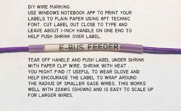

nuckolls.bob(at)aeroelect Guest
Posted: Thu Aug 01, 2019 9:53 am Post subject: Marking Wires |
At 11:06 AM 8/1/2019, you wrote:
| Quote: | | You're right; it won't shrink enough for 22 AWG wire. Shrink some small, unmarked shrink tube on the wire. Then shrink your label over that. |
Another option:
[img]cid:7.1.0.9.0.20190801124848.009a1ff8(at)aeroelectric.com.0[/img]

cluros(at)gmail.com Guest
Posted: Thu Aug 01, 2019 5:00 pm Post subject: Marking Wires |
1/4" is the smallest for the Dymo. I think I'll order a bunch of clear heat shrink and use Bob's method.

5 years later, still legible. Except in the engine compartment. Some of those are getting hard to read from dirt/oil/grease.
To save on the cost (and reduce the size of the labels), I use a wire numbering system:
Group/Device-Segment/Wire-Gauge
http://www.velocity-xl.com/blog/wp-content/uploads/2013/11/2013-11-06-IMG_20131106_095231_784.jpg
This is the Nav/Strobe lights (L1). The red wire is the first wire for that device (1) and the first segment (A). And it's a 20AWG wire. On the other side of the connector is L1-1B-20. And if there's another it would be L1-1C-20.
The downside of course is that you have to have the document that describes all the wires.
