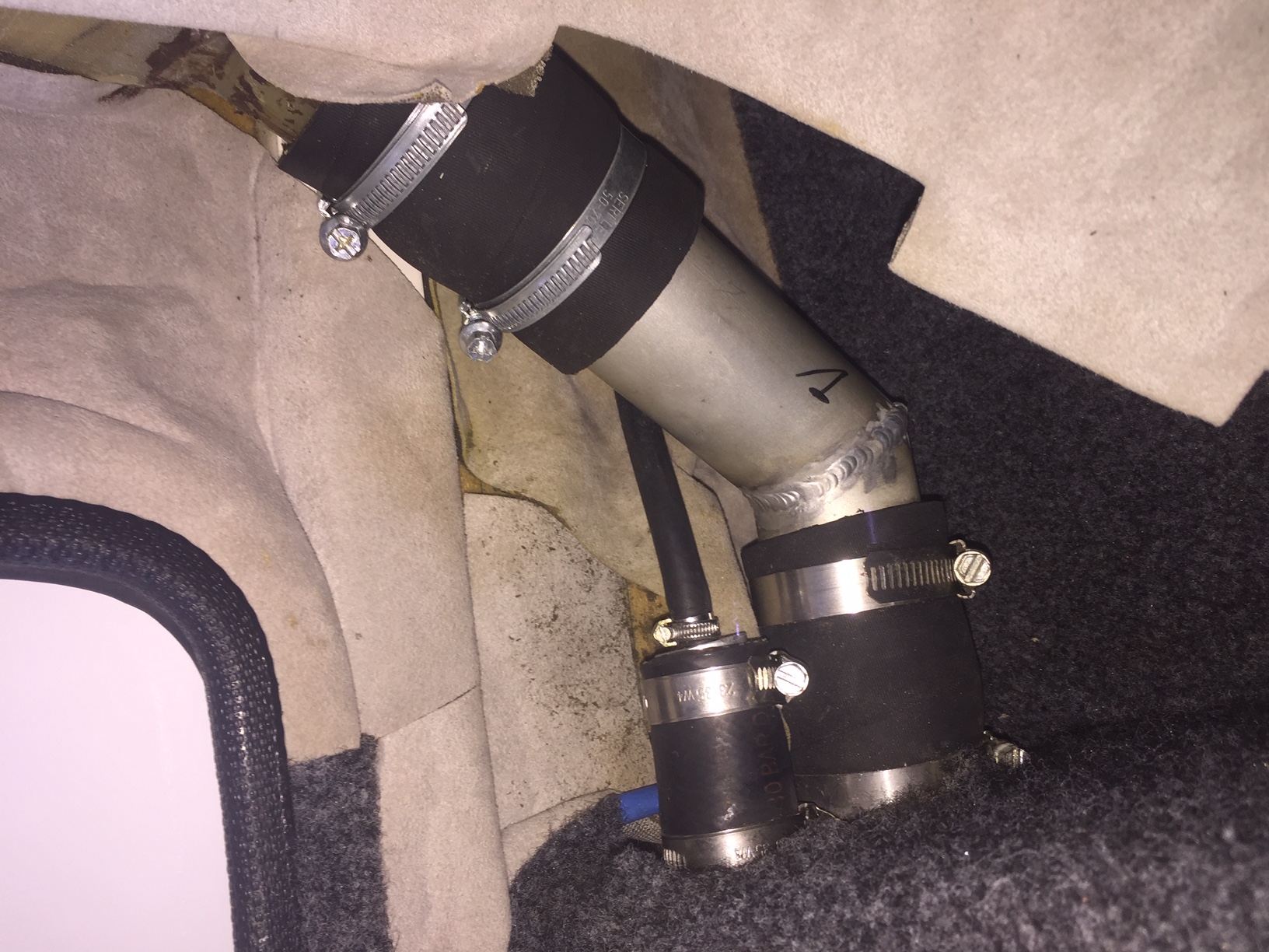

hello,
I’ve leaking fuel lines located there (see attached) I don’t know if I should replace them (I can’t find it in the europa catalog or spruce) or if I can put a loctite fuel sealant (however I'am afraid of contaminating the circuit...)
What do you recommend ?
Emmanuel

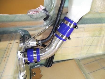

Hi Emmanuel
This is a known problem and can be fixed by using fuel resistant silicone hose like Samco ProFuel.
You are already half way to the solution by using the alloy bend. The original fit used an angled rubber hose which was identified as the source of fuel smells and was also found to deteriorate quite badly.
There is a mod issued by the LAA in the UK - copy of the modification attached and a picture of the finished assembly.

I come back because I didn’t solve the problem.
I have a big leak at the ventling outlet. The diameter at the tank outlet is
2,75-2,82 (it is a little bit ovalised) and the diameter of the outlet aluminium tube is 2,54...
So I don’t know which fuel tube I should use (25, 28?)

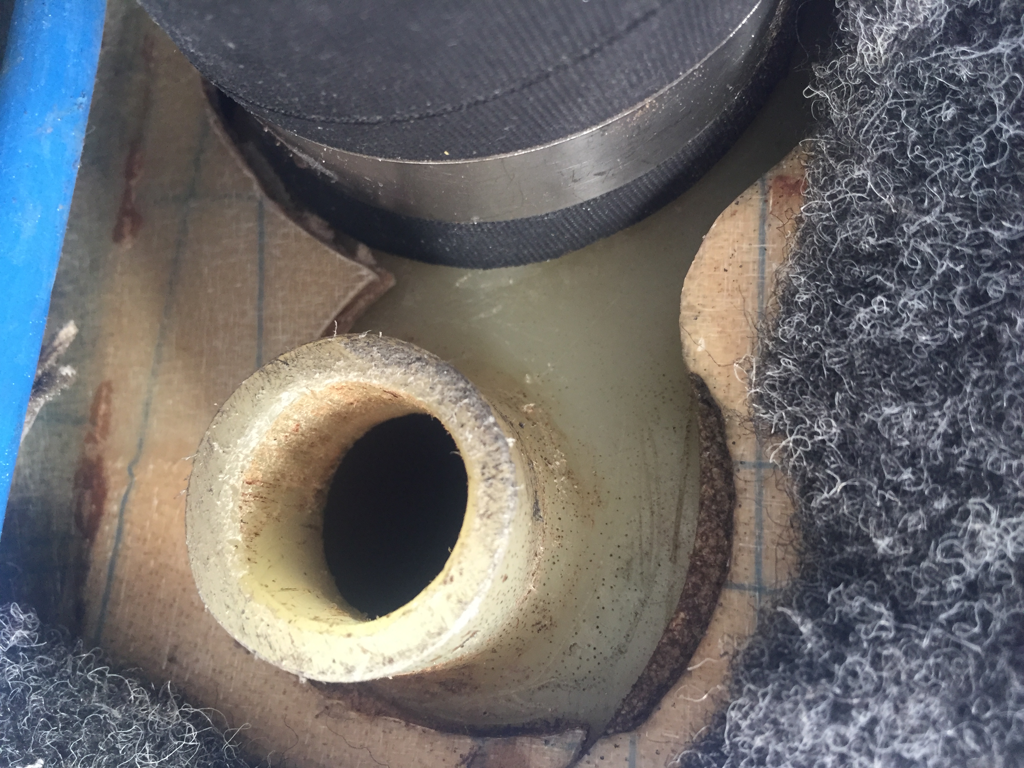

Hi, some news...
I purchased a reducer hose 28/25, but couldn’t stop the fuel leaks...
That’s now a mistery... I pray to don’t have a cracked gas tank... I can see no cracks but how to be sure...
I want to try a sealant, what should I use, epoxy resin?

PostPosted: Mon Sep 23, 2019 4:02 am    Post subject: Re: fuel odor in the cockpit Reply with quote
To locate exactly where your leak is, purchase a kit that has dye that you put into the fuel. You then use a black light and goggles to find exactly where the leak is located. The kit is not expensive and works well. In the states, you purchase the kit from an auto parts store.
Jim & Heather
roddyeuropa(at)aol.com
PostPosted: Mon Sep 23, 2019 8:05 pm    Post subject: fuel odor in the cockpit Reply with quote
Something else you can try is pressurise the tank (a very small amount!) and
listen for leaks, assuming you can do this in a quiet place. This worked for
me, Turned out to be the gasket on the fuel sender. At about .5 psi you
could hear the hiss of escaping air. I think I did this using a valve from a
bike tyre, connected to the vent with some rubber tubing.

PostPosted: Mon Sep 23, 2019 11:50 pm    Post subject: Re: fuel odor in the cockpit Reply with quote
I must admit l read Roddy's post twice before realising he states 0.5 psi (not 5 psi).
For reference the CS-VLA requirement is 2.03psi (non-metallic, supported fuel tank). This is normally factored up by 1.5 for testing purposes, although l don't know what pressure Europa used for their compliance demonstration.
I think Roddie's advice is sound, however, l found the fuel smell was not a leak but porosity (at a vapour orifice size) which can be cured using a suitable sealer. Caution is needed to ensure the sealer is MOGAS and Ethanol resistant. Apply on the outside of tank filler trunk and fittings.
Using Super Unleaded with zero ethanol helps reduce the tank porosity derived smell (regional variations exist, check the manufacturer's technical specification and regional delivery guidelines).
