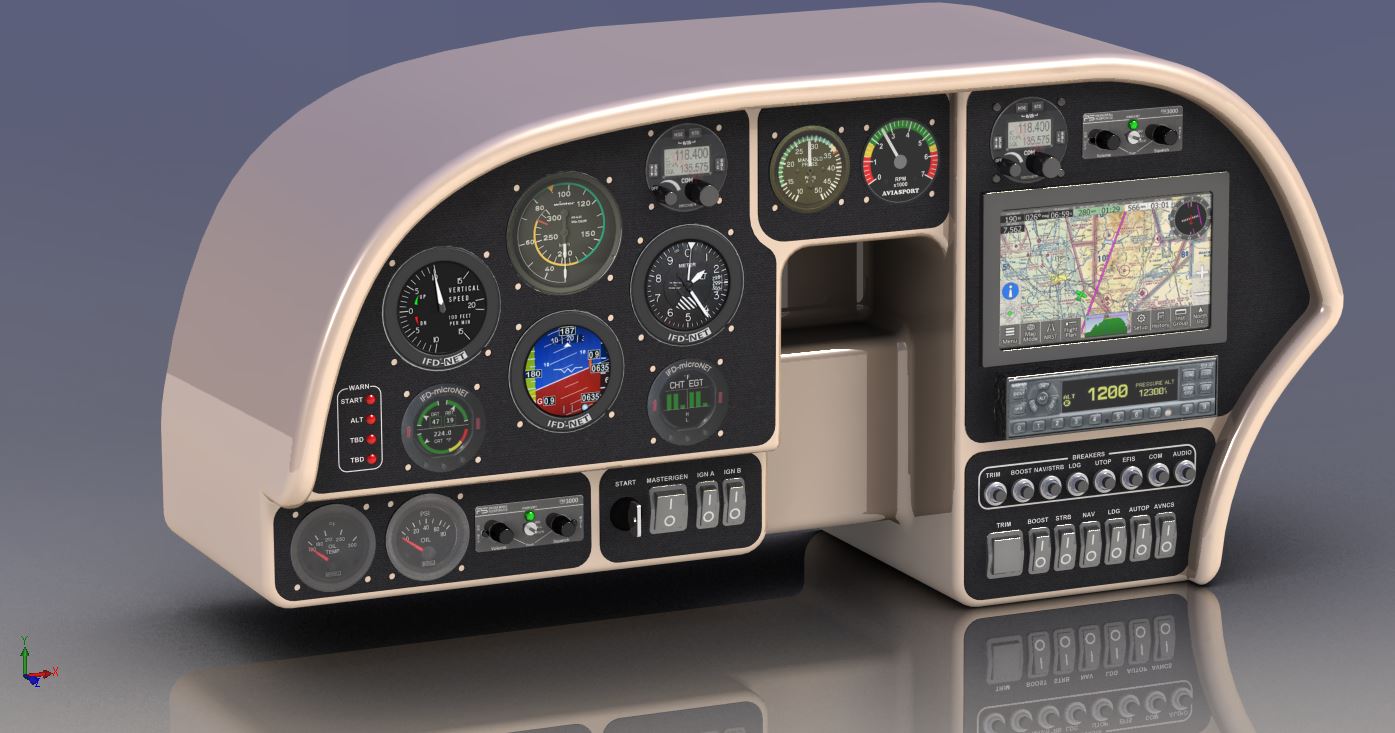

I modeled the panel module for my mono in SolidWorks and created what I want to be the panel in my airplane. I have printed the panels full size and checked them in my module for fit (and adjusted as necessary). As it can be appreciated in the picture, I am going for a different panel arrangement than traditionally used. I am looking for a VFR only panel at this point.
I am not going to use the IFD-NET instruments shown in the picture since they have proven not ready for prime time when I tried to install (read wasted my time) them in my LongEZ (too bad since it is a great concept with descent hardware, they just don't know what they are doing from a software standpoint).
I can provide DXF but please note that my panels are subdivided in subpanels. I am doing this because I think it looks neat but also because I want to modify things often and rather have a number of smaller panels to change. I am also going to individually connectorize each panel to make removal easier (like airliners do).
Anyway, let me know if interested in the dxf. I will need a few days to get to the computer and convert to dxf. I can also do a dxf of the entire module so that you can convert the modular panels into larger panels as in the original Europa.
Warning: don't trust the fiberglass instrument panel module model, it's just an approximation of the real one. The panels themself are accurate, not the module.
Chris
