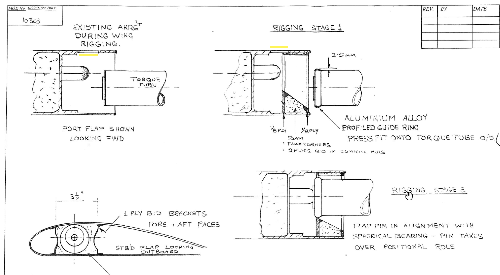

Question: Do I need a hole on the top of Flap Root to inspect and see if Flap Drive Tube is engaged?
Ron P.
Hints for anyone wanting to do this Mod: I turned one side of the alignment spigot (.003") less than the OD of my Flap Cross Drive Tube. When I fabricated Profiled Guide Ring (out of 7075 aluminium), I bored till my Spigot barely slid in place when Ring was about 100F from turning. I scuff sanded ID of ring and OD of Flap Drive tube, heated Ring with heat gun and Loctite 638 in place. I turned a scrap of aluminium to act as a install tool with pocket for spherical bearing. The ring is not going anywhere anytime soon.

Note 4 on the Mod sheet reads “Half of observation window remains in flap closeout” so I’d guess it was written to be fitted after the flap closeout was built and the inspection hole fitted.
The implication being the hole is still there, but now half blocked by the guide cone. The hole, filled with a perspex window, is visible in the top drawings.
HTH,
Paul M
