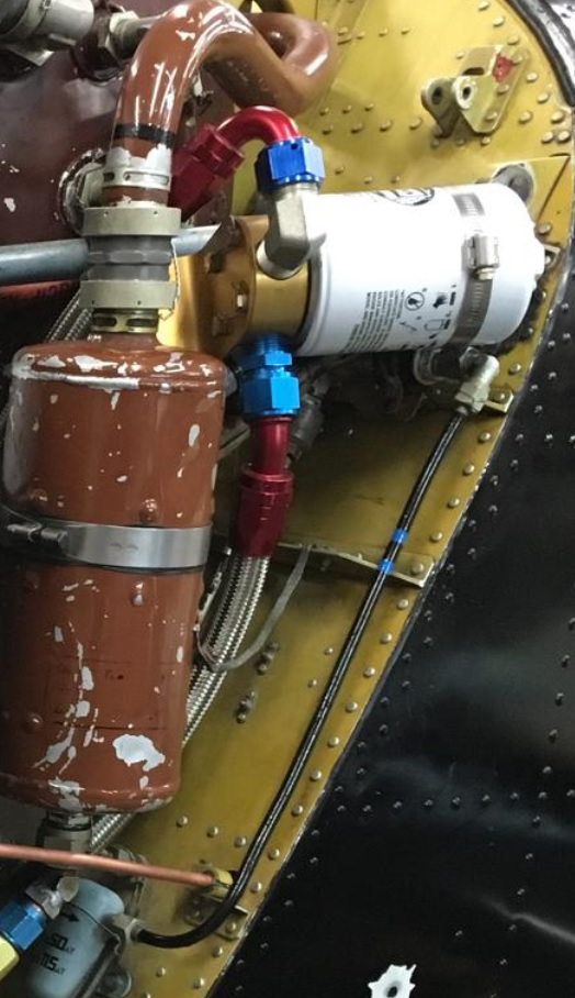

Which remote oil filter setup is this?
1906
Joined: 30 Nov 2018
Posts: 58
PostPosted: Thu Oct 10, 2019 2:09 pm    Post subject: Which remote oil filter setup is this? Reply with quote
Can anyone tell me which remote oil filter base is in the attached picture? Is it the Sukhoi Airwolf setup?
Thanks.
 Filesize:  134.43 KB
 Viewed:  6833 Time(s)
Ttail
Joined: 24 Jun 2013
Posts: 122
PostPosted: Thu Oct 10, 2019 3:07 pm    Post subject: Re: Which remote oil filter setup is this? Reply with quote
Air Wolf setup.
http://www.airwolf.com/aw/products/remote-mount-oil-filter-kits
This is the set I have fitted to a CJ6 M14:
1906
Joined: 30 Nov 2018
Posts: 58
PostPosted: Thu Oct 10, 2019 6:13 pm    Post subject: Re: Which remote oil filter setup is this? Reply with quote
Thanks Ttail. Did you make the hoses & choose different fittings yourself? I saw your setup in a different picture and those pieces don't look like the standard ones that come with the Airwolf kit.
Ttail
Joined: 24 Jun 2013
Posts: 122
PostPosted: Thu Oct 10, 2019 9:18 pm    Post subject: Re: Which remote oil filter setup is this? Reply with quote
We used new -12 hoses and new fittings we purchased locally in Aus.
