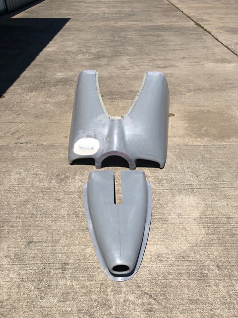

Save yourself all the heartache and pain by cutting off the snorkle and making it removable. Much easier to fab cowling to aircraft and filter box transition. Makes it WAY easier to remove the cowl. If wanted you could even do an oil change and service your fuel injector servo without removing the top or bottom cowl halves. If desired, you can now make the lower cowl 2 piece (split down the middle) for simple one person removal/installation.
[img]cid:EFB2C91D-B61B-437E-A175-13AC857C726F[/img]

PostPosted: Tue Nov 05, 2019 7:32 am    Post subject: Installing the engine cowl Reply with quote
Method?
Draw the cut line.
Cut through outside with Dremel tool leaving 1/4" tabs / attached sections every foot or so.
On inside, scuff the cowl surface / put release on the snorkle surface. I used PVA.
Lay up 3 layers of glass in strips that will become the flange. Let cure.
Drill #40 holes that will become the fastener locations.
On the outside, finish cutting the tabs that were left and pop off your removable snout.
Clean up the edges providing the usual paint gap.
Install your favorite means of attachment. Nutplates work fine.
Enjoy the ease of a two piece lower cowl.
Joe

PostPosted: Tue Nov 05, 2019 7:59 am    Post subject: Installing the engine cowl Reply with quote
Thank you Joe
I’ll give it a thought
Carlos
