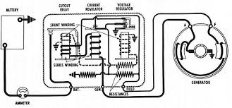

Assuming wiring integrity, You're down to the switch, generator brushes/internal connections, and the regulators internal connections. If you still have the the original style regulator on a plane of that age, it would have what amounts to a handful of mechanical relays in it.
[img]cid:part1.47DF85ED.9AFEED52(at)gmail.com[/img]
If the contacts are starting to burn/corrode, it'll cause random failures. You might find that you can remove the cover to inspect the contacts.
Charlie
[img]cid:16f29a45d051784666c1[/img]
Charlie
